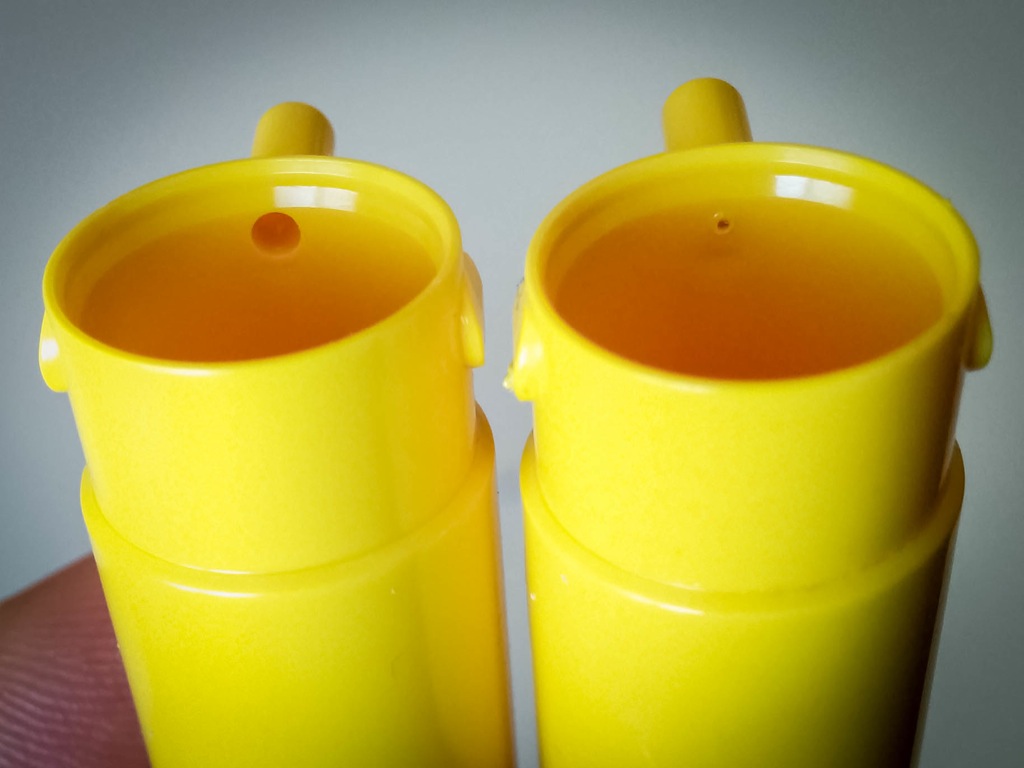

nicjasno Posted February 3, 2015 Posted February 3, 2015 The speed is basically regulated by how small the air inlet hole is. The big cylinders have a tiny inlet hole, so that air enters slowly and mimics hydraulics. The small ones have the same size hole, but there's a much smaller volume of air to fill, thus they move much quicker. Also, the seals are smaller and offer less friction. The cylinder on the right is how the stock inlet hole looks like from the inside: Quote
