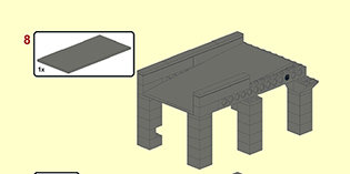

Instructions for Akiyuki's Train Module are now tested and complete and are available here. This Module is really made up of a bunch of smaller modules. I've listed the parts lists sepately for those who don't want to build the whole thing.
Most of the credit for reverse engineering this module goes to Courbet who did the work making an LDraw file with instruction steps. I had the easy job of formatting the instructions.
The Train Module is really a series of smaller modules, not all of which are required to make a layout. At minimum a motor, loader, switch, and unloader are required. The crane loader can be swapped for the simple loader. If a siding is added to increase throughput, then an additional motor is required. If you want to build everything then there is a loader, crane loader, siding, 2 motors, switch, unloader, and connecting tracks. The instructions show how to make 3 different layout options, but of course there are others. The images below show how many of each sub-module would be needed for each type of layout. The last layout uses the most parts, but still does not include the loader because it uses the crane loader instead.
This is a really complex module, perhaps even more so than the Ball Factory. Unlike the ball factory, relatively little timing is required. The crane itself is self timed because every mechanical motion drives another. The triggers need to be timed to fire at the right point in the cycle. This is pretty straightforward. There is some additional timing in the "timer" of the crane module at the worm gearboxes, but if you orient the parts as shown in the instructions it will work correctly.
As has been elsewhere discussed, I had problems with the power requirements of the crane. Anyone interested in adding an extra motor to solve this problem can see my previous post on the matter.

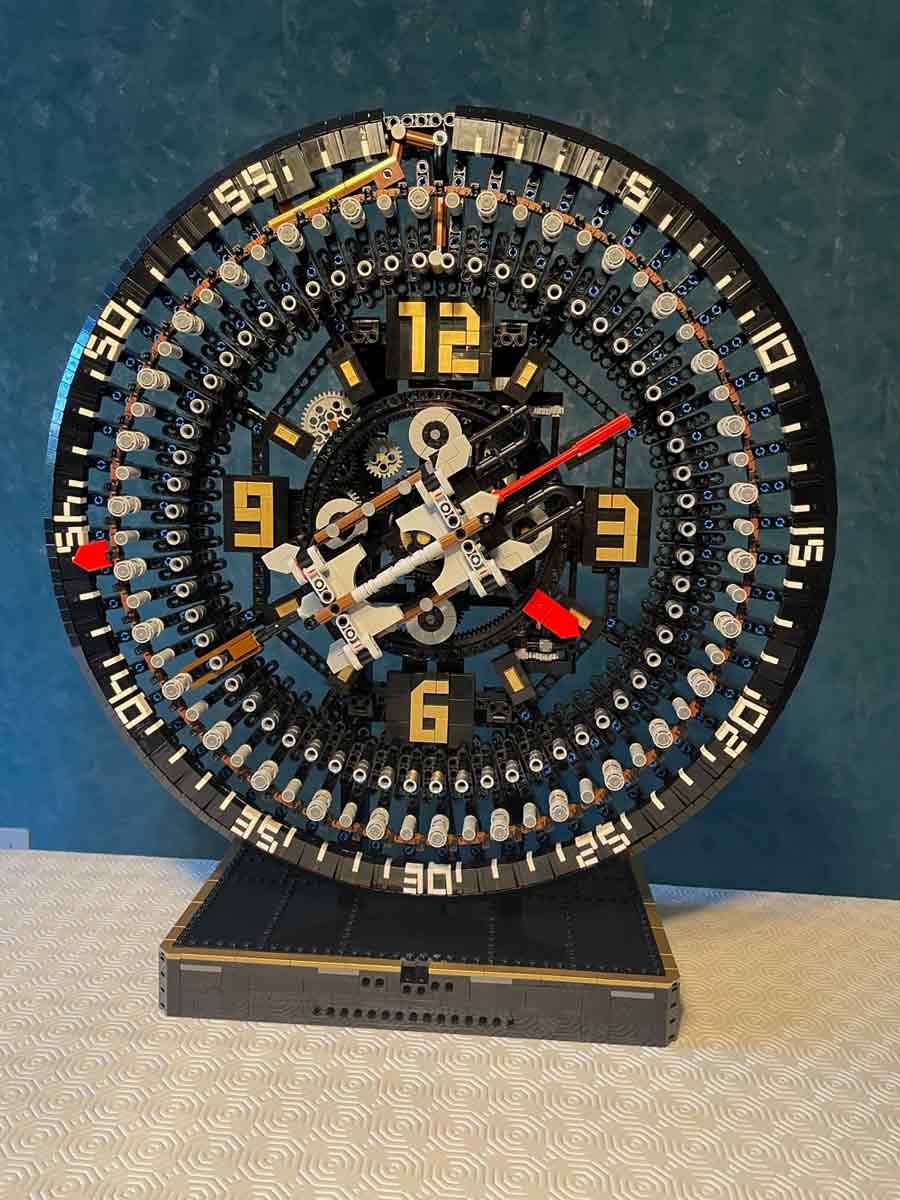

I've been working on a copy of Akiyuki's mangle rack clock. I'm 90% there, but still have a few details to complete and some 'wrong' colours to swap. Otherwise it's looking good.
Is any one else working on this project?
