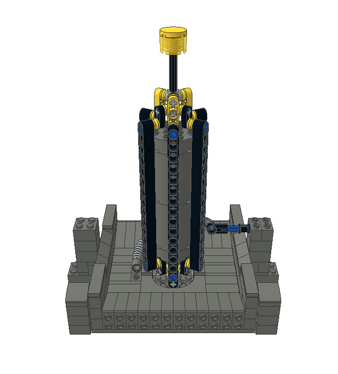

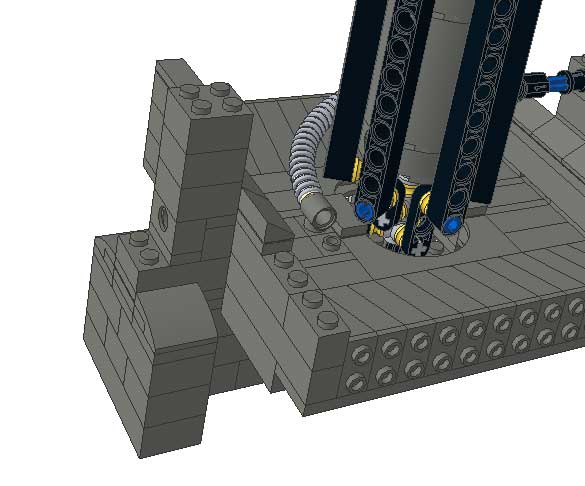

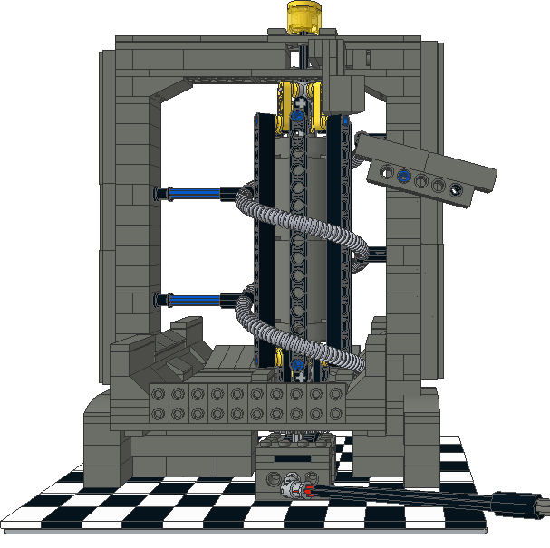

I have been actively working the Archimedes Screw instructions and have completed a first draft. Courbet, would you be willing to disassemble your model and use the instructions to rebuild it as a test? I need the instructions tested but do not yet have the parts to do it myself.
looking good so far. make sure to put the box connector on the end so it will work with other modules.
