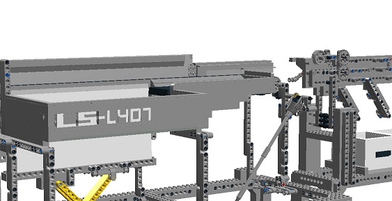

Dabbling in LDD I think I have completed Lift Arm Sorter: LS-L407
I have to brick build it still.
Weighing in at 3703 pieces, I believe I have nailed it to Akiyuki Accuracy, but Blakbird will be the better judge of that. He has an eye like no other!
I brick built the nameplate to make sure I got that part right. :)
Wow, that liftarm sorter is going to be awesome. I'm excited to see it work.
Always great works,TheRebricker^^ I believe that this is most exciting!!
