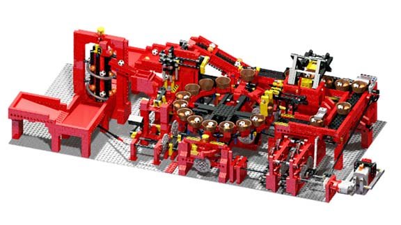

Wow, thank you Rohan, Berthil,and Ankoku for your prompt responses and outstanding information and advice. I think that buying The Bucket Wheel Excavator - 42055 for parts is an outstanding idea. I have seen it on sale and will continue to track the pricing.I saw on the PV-Productions website that they made a GBC strictly out of the parts from that set, without adding anything extra. I have the Lego Technic Crane 42009 in my closet (unopened) and all of the extra parts to build the MOC 5509 Groove MKIII crane. That is my fall project with another grandson. Once I see what leftover parts I can use for the Great Ball Factory, I will order the balance of what I need. The Ball Factory will be a winter/spring project for me. But living in the Palm Beach, Florida area, winters are pretty nice! I might try to build the Fork - to - Fork with wheel lift first. I think I can incorporate that into the delivery system of the Great Ball Factory right where the balls come off the last conveyor and back to the staging tray to be brought up in the spiral lift. Everyone on the forum is amazing. BTW, one of my sons had a ton of red Lego bricks leftover from his childhood. I scavenged what I could, therefore, I will be building the Ball Factory in red, with lots of black and yellow technic pieces.
Edited by rskamen
That is very red. Could be tricky getting a red L PF-Motor as shown in the image :D

Thank you all for your advice, encouragement, and warnings. If certain parts in red are too expensive, I may just use black or yellow as substitutes, as long as the overall color scheme looks pleasing and relatively symmetrical. I am finding that doing the research of the project, scouring websites, watching videos, and reading building manuals, is rather enjoyable. I am not easily frustrated and look forward to building this one module at a time. Testing and running one module at a time. And, integrating additional modules, one at a time. I think this will go a long way to understanding how each module functions, and it's timing and relationship to the modules in front of or behind it. Using a gray L PF motor is fine. I would not pay extra for a red one. I am not that much of a purist just yet. I think that the judicious use of alternate colors (black and yellow) will also help highlight some of the individual working components. I will continue to watch everything posted and continue to educate myself on the terminology, process, and outcomes. Stay tuned for more questions from me.
