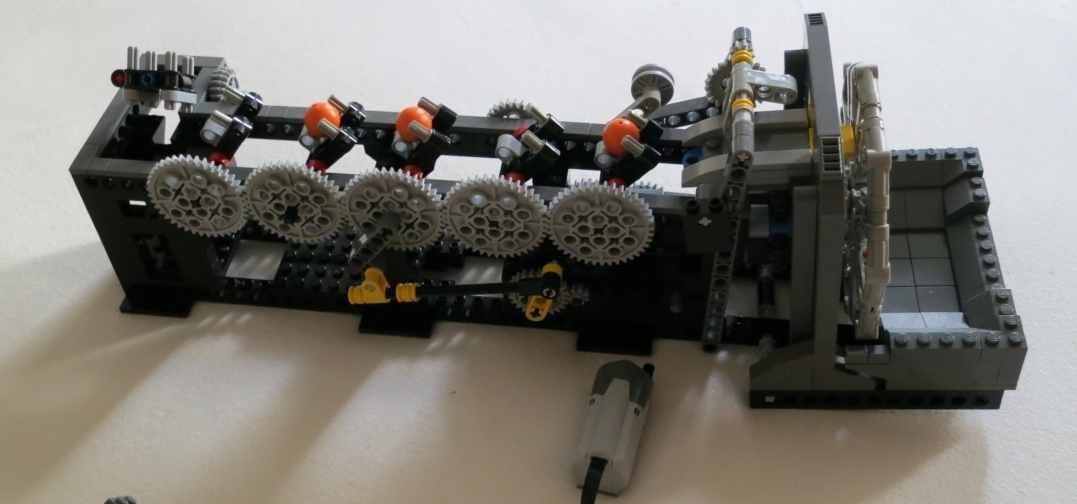

@drullph20 How did you build the gearing of the first stepper part with the M-motor? I’m not very happy with mine, it doesn’t run very smooth. I have used a 24 tooth clutch gear and a 16 tooth gear.
I connected M-motor through 8 tooth gear moving 24 tooh clutch gear,  and then on the transition  gear worm screw with 2 bushes. From this arrangment I moving energy to another 8 tooth gear which at the end elevating platform for balls. For better understanding, images below.

@drullph20 Thank you for your pictures. I have a similar set-up but the upwards movement doesn’t run smooth. Loaded with a few balls makes it worse. Do you have the same problems with the 8 tooth gear?
I think that my set up runs smoothly. Without any major problems. I will make video how it runs a get you the link for YouTube once is done. At the mean time i would advice you to work in reverse, take it a part up to the point of problem worth to re-check,etc. I will look at mine if I have any problems.
