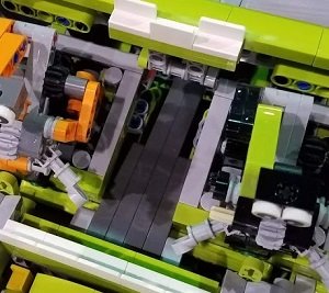

Finished the Catch and Spin modules.  They don't fit together perfectly for a quad loop, and would vibrate far enough apart to start dropping between the transfers after a few minutes of running.  Maybe if I put a proper towel and tablecloth setup below, they would work.
I like how effective the tuning is for the robot pickups.  If it is dropping balls, increase tension.  If it is not picking up properly, loosen tension.
Please excuse my crappy cell phone videos.
It all depends on were you plan on using it.  I am going to try to add some terry cloth and table cloth setup and see if I can get something that works for all modules, as most of my modules tend to move around on these cheap plastic folding tables.
Anyway, the Catch & Spin instructions are pretty straightforward and it is a relatively easy build, reminding me of building a studless lego set like 42043 Arocs.

I ran the Catch & Spin modules at the Brickfair NC this weekend.  Kept 2 in layout at all times.  The first one (dark gray) that I built, which had about 8 hr of runtime before the event worked flawlessly.  It didn't appear to drop many balls, and only had to stop once over the 14 hrs to clear a ball that managed to get under the infeed from the previous red C&S.  I only had a bit of testing with the other 3 modules, and swapped them in and out of the layout for testing.  Didn't end up tweaking them much to stop from fully dropping balls, but did add a guide to keep balls from going into the center gears.

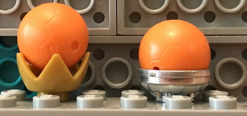

I'd love to build Cup-to-cup too but haven't got and am not prepared to pay for the cups. Do you know of an acceptable (affordable!) alternative?
Does that (whatever it is) actually work or does the increased height require some re-engineering? I have some wheels that are the right diameter but are too tall to be direct replacements.

Attached a picture.  I just had it laid into the gap, with it staying in place from the liftarms.  I also put a few technic bricks in front of the downstream catch and spin.
It will require re-engineering, possibly just changing the stroke.  Nevertheless, a cheap alternative at $0.37 each direct from lego.
Edited by BrianGT
Thanks. I'll add that module to my build list and investigate when it gets to the top.
