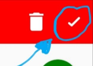

Hello. Please, do I do something wrong? I have new Buwizz 2. When creating/modifying a profile I cannot invert a motor direction, resp. I can switch it in settings but it is not saved. When I just exit the settings and open it again it is not inverted. Motor direction is still the same, not inverted.
How should I invert the direction so that it remains?
Are you sure you are exiting using the checkmark in the top right corner?
Uups. I knew I did something wrong. Stupid thing. Uuaaaaa. Now it works fine. Thanks.
