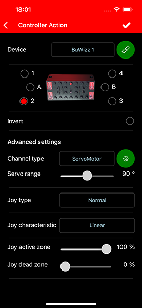

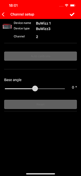

damirnis Posted January 21, 2024 Posted January 21, 2024 Hello all, It is my first time here. I created a nice 4x4 moc and wanted to use a PU L motor as a servo with BuWizz 3.0. I am unsure if it was discussed before, but I will look at the thread later. Just in case someone has more info on hand, please assist. Everything connects, but when I try to select Servo for the PU L motor, there is no calibration; it is grayed out. I have attached images of what I can see. Thank you for the support Quote
gyenesvi Posted January 21, 2024 Posted January 21, 2024 1 hour ago, damirnis said: Everything connects, but when I try to select Servo for the PU L motor, there is no calibration; it is grayed out. I have attached images of what I can see. Automatic servo calibration with Buwizz 3 unit is not supported (it was said it would be supported later, but it never arrived). So what you can do is build your model so that the absolute zero position of the motor is at least near the centered position, and then you can manually use the base angle to precisely center it, and the max angle to adjust for its max range of motion. Finding the absolute zero position of the L motor is tricky as it is not marked. The easiest would be to hook a bare motor (not yet built into a model) up to a Buwizz unit, make a simple Buwizz profile for it, start it, and let it return to its zero position upon startup. Then you build it into your model without rotating it significantly. Or if you have it built in, you may need to remove a pinion gear and adjust it if it's not at the zero position. Quote
Alex Ilea Posted January 21, 2024 Posted January 21, 2024 The servo calibration is available on Android phones, but it doesn't work nearly as good as Buwizz app itself. Brickcontroller 2 would be perfect if it had the better steering calibration and a version of Buwizz's own tracked steer module. Quote
Aurorasaurus Posted January 22, 2024 Posted January 22, 2024 I agree, a tracked steer function like buwizz app would be fantastic. For me steering calibration in buwizz app is buggy and rarely works, but always works in BC2. The most important thing is setting the base angle accurately, in my experience. Not sure how a tracked steer module would be implemented, maybe in the same way as buwizz app where you set it up then assign the output to the mixer thing. BC2 has helped me a lot, so thanks Imurvai! Quote
imurvai Posted January 22, 2024 Author Posted January 22, 2024 12 hours ago, Alex Ilea said: The servo calibration is available on Android phones, but it doesn't work nearly as good as Buwizz app itself. Brickcontroller 2 would be perfect if it had the better steering calibration and a version of Buwizz's own tracked steer module. Hi, yes, unfortunately the servo calibration is only working on Android yet - my ios dev environment went down and I haven't had time to fix it :(. Also my Buwizz 3 has stopped working (I left it in my drawer for a couple of months and now I can't charge it up), so not sure when I can fix it. Quote

damirnis Posted January 23, 2024 Posted January 23, 2024 On 1/21/2024 at 8:09 PM, gyenesvi said: Automatic servo calibration with Buwizz 3 unit is not supported (it was said it would be supported later, but it never arrived). So what you can do is build your model so that the absolute zero position of the motor is at least near the centered position, and then you can manually use the base angle to precisely center it, and the max angle to adjust for its max range of motion. Finding the absolute zero position of the L motor is tricky as it is not marked. The easiest would be to hook a bare motor (not yet built into a model) up to a Buwizz unit, make a simple Buwizz profile for it, start it, and let it return to its zero position upon startup. Then you build it into your model without rotating it significantly. Or if you have it built in, you may need to remove a pinion gear and adjust it if it's not at the zero position. Thank you very much for the reply, This helped and it works fairly good, doesn't have a good center back but it works for what I need it to do, On 1/22/2024 at 9:04 AM, imurvai said: Hi, yes, unfortunately the servo calibration is only working on Android yet - my ios dev environment went down and I haven't had time to fix it :(. Also my Buwizz 3 has stopped working (I left it in my drawer for a couple of months and now I can't charge it up), so not sure when I can fix it. If it is only a short time, find a 5V charger and leave it on charge overnight. If it doesn't switch on, you will need a new battery. Luckily, my unit was under warranty, so they sent me a new one. But thank you for this amazing app. I know how hard it is to set time on personal projects. If you have a PayPal support link, maybe share it so we as a community can contribute. Thank you again Quote
