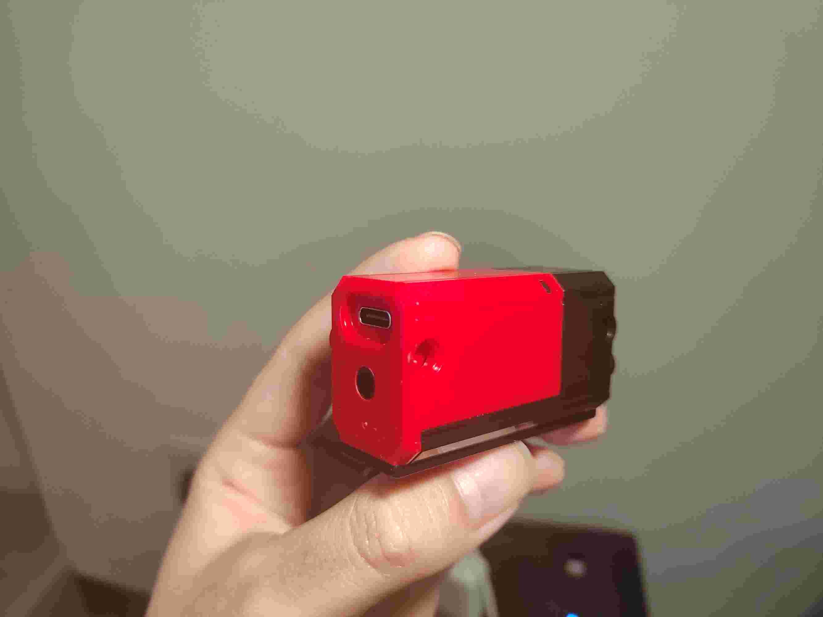

NightTalker1001000 Posted January 15 Posted January 15 Hello! I recently bought a Motor which includes battery, bluetooth control and motor. It means no wire and direct output. No SBRICK or Mouldking 4.0 or BUWIZZ . However, when I'm trying to use BrickController2 to connect this motor, I failed. If the app can successfully connect to the motor, that will be an economical way to use motor. Quote
