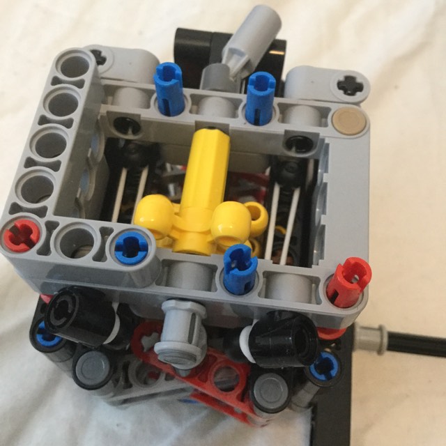

I made a small modification, while building my GT3.
Since what I really hate of this set are the elastics in the paddles, I hid them inside the mechanism of the original build. I hope you can see what I changed in the pictures below.
I'm only allowed 102.4KB, so I cannot upload more images :sceptic:

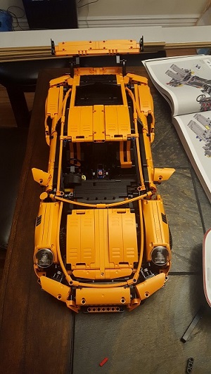

11 hours ago, Kasse said:
I'm no fan of soft axles, so here's yet another take.. :classic:
I do not really like looking at so many pinholes, but I like it nevertheless. To me - but that's personal - it looks more clean than the stock build. Maybe you could replace the orange liftarm in front of the front window with a black one to get a little more the illusion of a curved window. Wel done!
Good idea, it sounds worth trying and it's easily done. Pinholes yeah, I guess we both like panels :classic:
