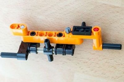

I think, I solved the puzzle!
Thank to @Didumos69 who triggered me several times to include his paddle shifter into my Pimp-up-my-porsche. When I played again with my Porsche, I noticed, that the old paddle shifters often stucked when they returned to idle position. So I was looking for an improvement.
Didumos used blue 1/2 pins to guide the yellow knob gears in exactly the right position for a smooth movement during shifting. This is the main difference between his and the original design. And it is much better than the original one.
I combined Didumos' geometry while keeping most of the original design (and parts) and the easy-to-mount rubber bands on top. This is the result:
I have updated my instructions and mpd file of Pimp-up-my-porsche on rebrickable.

Yeah- maybe i will add this shifter into my porsche- IMHO best Solution until now- this Is the Porsche TLG should have been released- if they'ed no complains would have been arised...

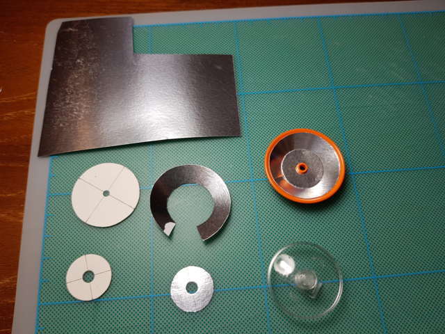

Hi, I'm a new member.
I would like to thank everyone who helped improve this set.
Here are some screenshots of my...
Next step I'll add led lights and I'll bring some improvements to the bodywork
Best regards from Italy,
Stefano.
Edited by barbanera
1 hour ago, Paknaloid said:
@barbaneraI like what you did with the headlight surrounds, haven't seen that before.  What part did you use?
plate 5x5 part 6942, but it's necessary to lower the headlight support to mount this part
2 hours ago, AFOL1976 said:
Which part(s) are "in" the 5x5 dish (under the 4x4 clear dish)?
No part, simple silver card stock but you can use also drink's aluminum tin
