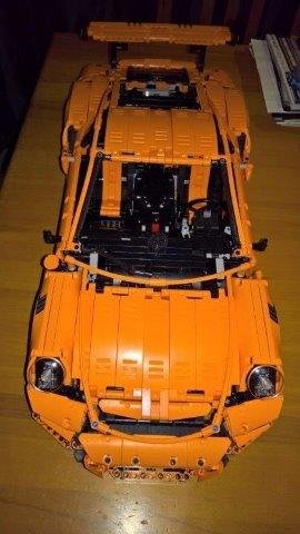

Can someone who owns the set comment on the required pieces to fill the gaps below the headlights please?
Edited by Mysh
look at the previous page...
Someone was able to mount a very small technic panel underneath the front headlamp, does anyone have instructions to do this?
Lol... I should have read your comments before I posted ?
On 4/28/2018 at 8:46 AM, fred-eric said:
In the version (am I not able to remember the author) I use, you need 3 parts an axle pin 43093, a  Axle and Pin Connector Perpendicular, and a 3L pin  6558
So the panel only connects with one pin hole used in the panel?... Does that not make it easy to move the panel?
On 6/22/2016 at 7:56 PM, brunojj1 said:
Everything is said about the Porsche, almost nothing left :wink: .. I filled in some gaps around the headlights and replaced the black 5x3 beams at the fenders, front lights are lowered a bit.
I don´t claim this as an "improvement", all just a question of taste because the bodywork is considered as the best part of the car by everybody.
I wonder what brunojj did, because it looks way better.
Many thanks anyway!

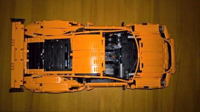

Here are few additionnal body changes, if interested.
The first one concerns the front hood, with an additionnal fixation of the flexible axes (close to the windshield) for a better control of their shape and a lateral extension of the front hood.
The second mod concerns the top roof close to the windshield to suggest its curvature and add a central mirror (for fabrication, look at photo number 2 : modifications are not so much complicated). Of course, you need to shift the central 3x11 orange pannel.
