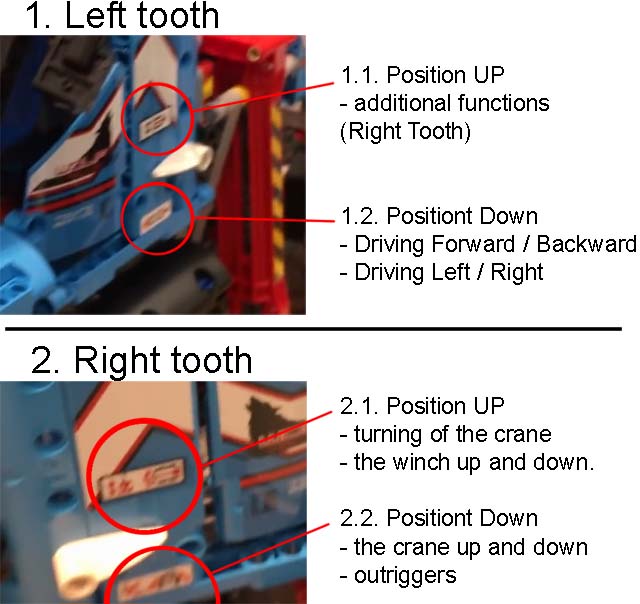

15 hours ago, Miscman said:
At :53, you can see the passenger side switch in the up position controls the turning of the crane AND the winch up and down so there must be a 3rd switch to select between the 2 functions somewhere.  The drivers side switch seems to be steering in the down position and extend outriggers in the up position. The only function I can't find a control for is the crane up and down.
simple, two motors=two functions!
Yes, I agree with you that the "right tooth up position" to controls the turning of the crane AND the winch up and down.
Offer my version of the functional on image:
Edited just now by Vicont45
image attached to the post. link by image sharing to deleted.
Such a gearbox setup with "additional functions" seems unlogic. This would meen that the truck can drive and operate the crane at the same time if booth levers are not in neutral position wich makes no sense for such a model. The driving part is highly decoupled from other functions. The lever on drivers position simply controls the wish of drive or none drive and the lever on other position controls the current 2 crane / outtrigger operations. This setup means that there are only 2 functions active and switching the Operation lever has no effect when using drive mode. This is called 3-way-gearbox like in the unimog
1 hour ago, Timorzelorzworz said:
This would meen that the truck can drive and operate the crane at the same time.
No, you did not understand me correctly. I also had in mind 3-way-gearbox.
In position "Left tooth Down" works only Drive the movement, while functions to controlled by the "Right Tooth" is not active.
In position "Left tooth Up" Drive the movement is not active, but works the functions "Right Tooth" (crane and outriggers)
Yes, it is quite likely. Because in the Unimog 1 motor drives the 3 functions, and in the 42070 - 2 motors drives the 6 functions. All converges.
Edited by Vicont45
Agreed. I really like the idea behind this set and I think the gearbox is still interesting. For me a true flagship
