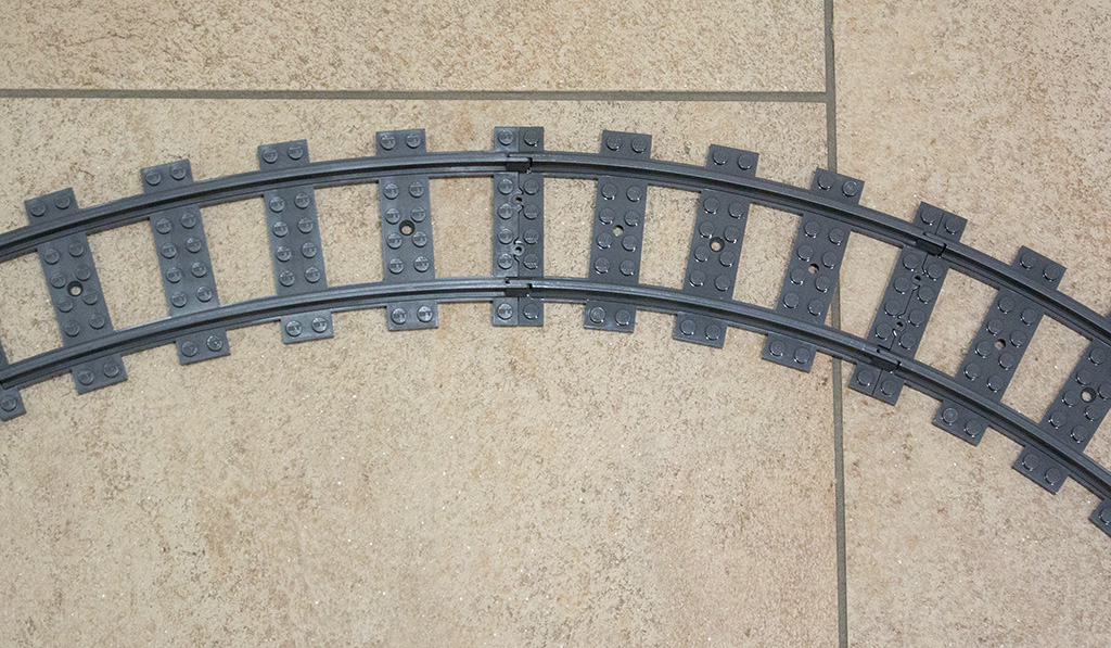

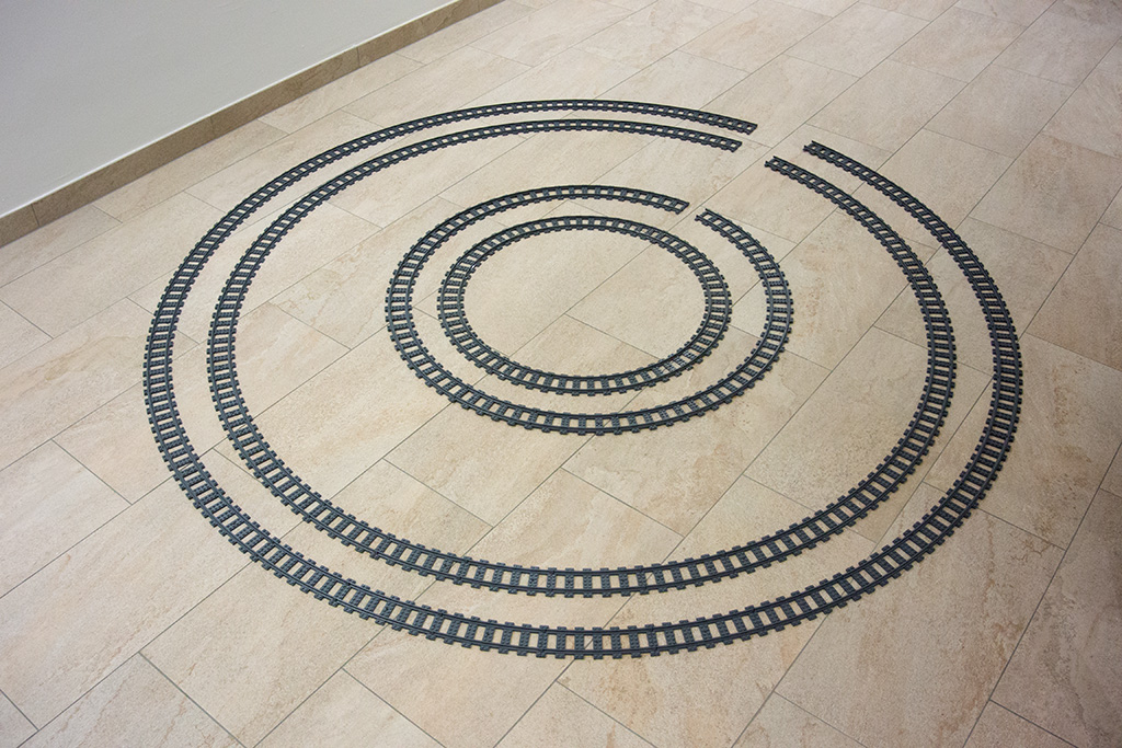

Today I've used the BrickTracks I've bought a few months ago for the first time and noticed a strange issue with the geometry. When putting no stress on the tracks, there is almost a gap of one piece. Is this by design, e.g. for superelevated tracks? I've not tested the tracks after purchase, so it might also be possible that they deformed over time.

The deformation is something we've battled with on and off.  We initially had issues with them coming deformed out of the mold, but that's been fixed, and we do spot checks of circles with each batch.  We do get comments on this occasionally, and seems to come up most in summertime.
The best thing to do is pin them to shape with some 2x4 plates and leave them that way for a while.  If needed, add a little bit of heat with either a hair dryer or put them in hot water.  They should relax and return to shape.
For finish, unfortunately, those are as good as we can get them.  The first tracks we made were done in aluminum molds, and it is much more difficult to hold a high polish in the aluminum.  The short straights and everything moving forward are all steel tools though, so they have a much higher shine like the LEGO ones.  We are also starting to  rebuild the curve tracks in the steel to improve the polish and implement a few changes which will solve the deformation issues for good.
Is this due to heat at the factory or due to shipping in hot trucks you think?
Im not sure a hair dryer puts out enough heat (unless I'm over speaking here as ive not had to heat tracks) a heat gun on low would be much easier imho
Just dont hold it in place too long or it will melt abs and deform your parts.
