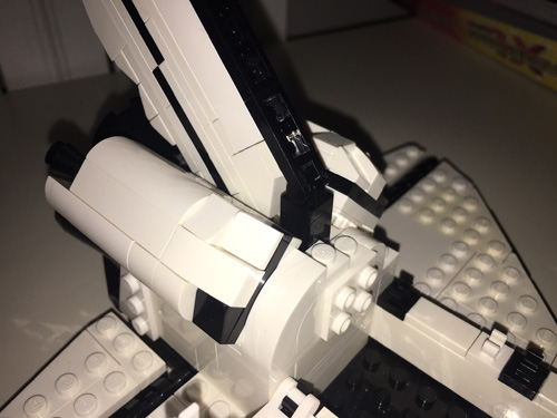

My stabiliser fin looks like this:
It's attached to four stud jumpers between the engines. It does tend to fall off if pushed hard but it comes off as one unit. I'm not sure how it could be made better without a total redesign.
