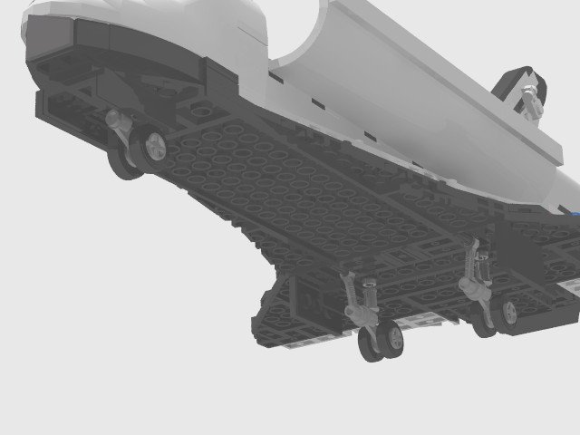

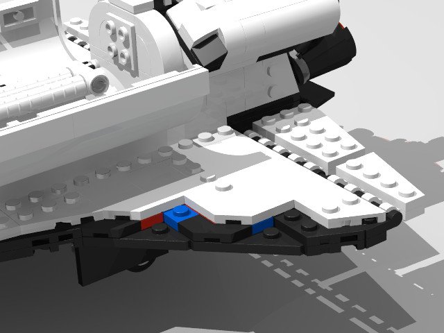

I am building the Orbiter in landing configuration in Stud.io. I used your suggestion about using the triangular tile 35787 on the wings. Unfortunately Stud.io does not support these in the current version so there are gaps in the model right now. I also made some modifications like at the side close to the main engines. I also put tiles in the cargo  bay.
A big problem for me is the landing gear. I need to find a solution on the real model. I ordered the parts and continue hands on when I received them.
