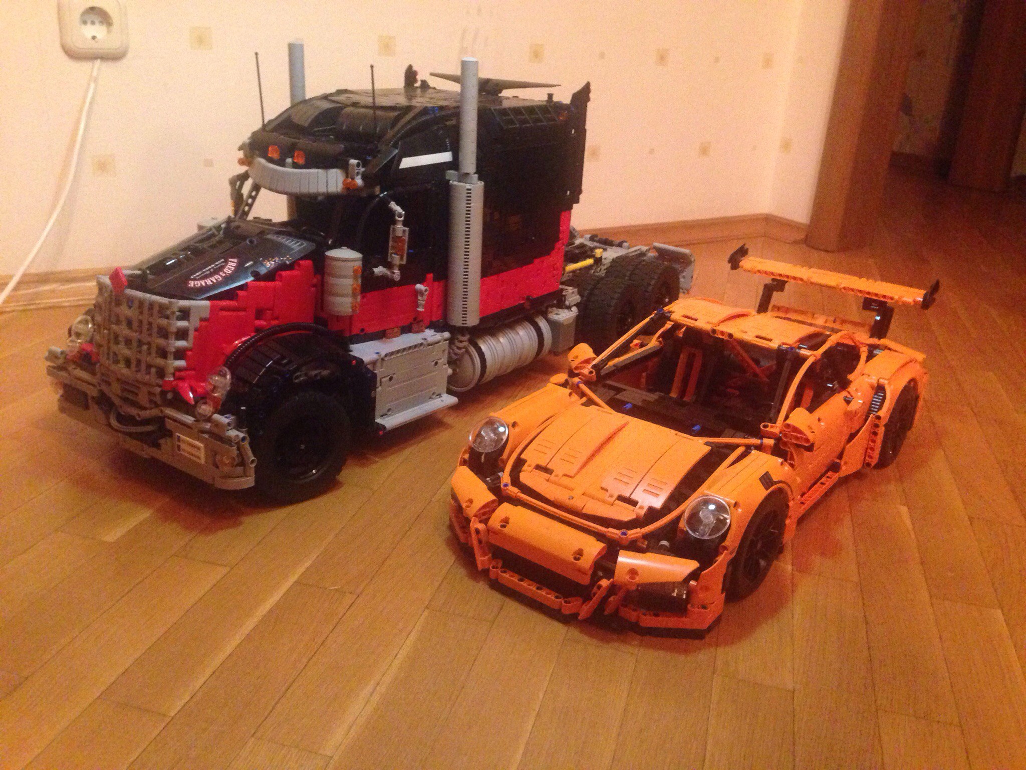

Aleh Posted August 24, 2017 Posted August 24, 2017 (edited) Hi guys! At least I has finished my next MOC and want to introduced the finished model to all of you! Welcome my International Lonestar truck! It's dimensions are: - Lengh: 101 stud or 80 cm - Width: 31 studs or 25 cm without mirrors - High: 37 studs or 30 cm excluding antennas and exhaust pipes. It consists of more than 5000 Lego parts, including 9 motors. It has: - Great Charbel's 8 speed gearbox, modified by me to the 16 speed one by adding high/low gear to the main output. It has a special shifter. It's all RC. - Independant powerfull pneumatic brakes on each wheel. Inspired by Sheepo's Peterbilt. - Pneumatically controlled fifth wheel. - Independant suspencion on front and dependant one on the rear axles. - Suspended driver's and passenger's seats, doors with locks and shock absorbers. - Detalized interior. - Inline 6 cylinder engine like the real truck. Power functions is described at the picture below, I think this is more interesting than just to read. Also I include pneumatics sheme. Enjoy the pictures please, I hope some video will apear nowadays. Unfortunately, rear differentials can't cope with such a huge torgue and truck cant drive fast on the floor, sorry. Please visit my Bricksafe page for more photo. Building instructions are available here: https://rebrickable.com/mocs/MOC-9788/OleJka/international-lonestar-truck/#comments VIDEO AVAILABLE NOW!! Edited November 22, 2017 by Aleh Quote

WvG_853 Posted August 24, 2017 Posted August 24, 2017 Wow! So it is possible to build a "Technic only" truck without relying too much on non-Technic bricks for instance for the grill/nose. Impressive! It would be interesting to have a picture with another well known Lego technic set to better realsie the size of the truck. Quote

Aleh Posted August 25, 2017 Author Posted August 25, 2017 8 hours ago, Saberwing40k said: You pulled it off, and it looks excellent. Shame about the diffs, though. Thank you very much! 8 hours ago, Leonardo da Bricki said: Congrats on finishing this behemoth! It looks great, too bad it cannot drive well. Functions sound cool, I will wait eagerly for the video. Thanks! Me too honestly Hope I will deal up with video soft)) 8 hours ago, Leonardo da Bricki said: Also, your title has a typo. Not a big one, but it should say "International...." And again thanks, fixed! 8 hours ago, rm8 said: WOW! Is it real? Egor, actually not - this is from Lego. If seriously yes - this is a physic model, not a virtual renders. 8 hours ago, nerdsforprez said: Geezo.....this one is gonna require one long stare. Rarely do I have 5he time to read and fully digest a moc, but this one demands it. Initial impression is fantastic. Excited for the video. I'm waiting for you critics 7 hours ago, Jeroen Ottens said: Wow, black cat on steroids! There is a smoothness around the cabin which is great. The grey windshield is a bit too prominent for my taste, but that might be in the original as well. And that pneumatic tubing... that's a bit messy isn't it... Too bad it is quite difficult to properly fixate the rigid tubes in studless LEGO... Still this is just nitpicking on a great MOC. Looking forward to the video. Unbelievable, but on the next shelf I have a 5571 truck, but I'm so stupid, that I didn't guess to make a common photo, unfortunately.. 6 hours ago, WvG_853 said: Wow! So it is possible to build a "Technic only" truck without relying too much on non-Technic bricks for instance for the grill/nose. Impressive! It would be interesting to have a picture with another well known Lego technic set to better realsie the size of the truck. Simply I do not have model team parts for building Only this for comparison. I'll try to photoshop this Lonestar with 5571. 7 hours ago, BrickbyBrickTechnic said: I have been waiting for this! This is simply beautiful! So complex! So accurate! I could go on and on about this, and I think I will nominate this for HoF! Great job! Sucks that it can't drive, but that's what happens when you add weight. 1 hour ago, Aventador2004 said: Hof! Don't worry about driving, it is beautiful! Thanks for understanding! I will measure parts weight ASAP. Quote
