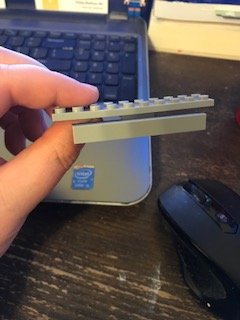

I'm new here. My kids were playing with my Millennium Falcon and the piece in the pic (along with a lot of other pieces) fell off. I got it back together but can't figure out where this piece goes. There is a chance it is from another set they were busy destroying but I'm pretty sure its from the Falcon. Any advice on where it belongs or what # in the instructions it goes with?
