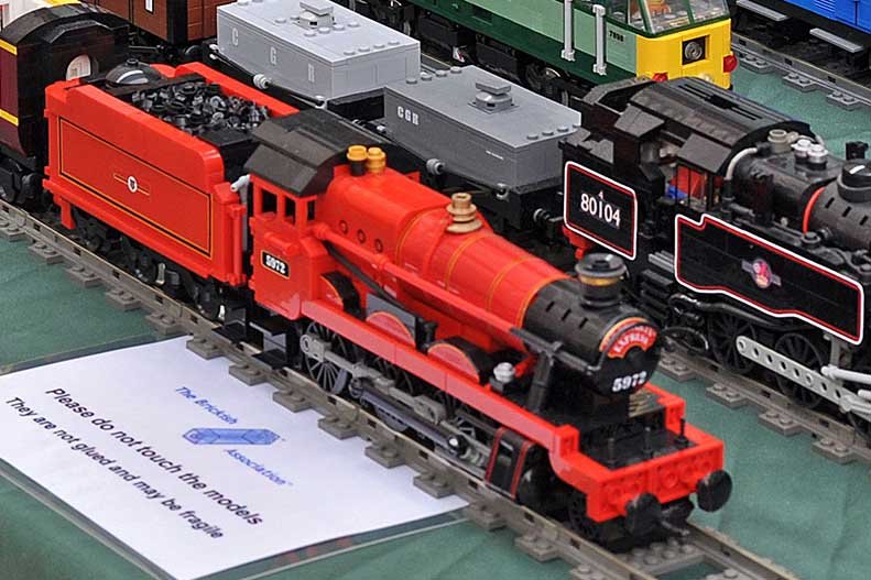

I do think they missed out with not being able to motorize it, especially now that they don't have a receiver to worry about. I suppose the problem is that the PU parts aren't available separately yet. Otherwise, I reckon the set is pretty good; even if all the proportions are a bit off, it's the best official representation of Olton Hall we've ever received.
It's certainly closer to Bricktrix's original model from eight years ago, as shown in this (poor) photo.
15 hours ago, Goldenmasamune said:
What did he make the boiler out of? I've seen better pictures of this model here: http://www.brickshelf.com/cgi-bin/gallery.cgi?f=432359
and it almost looks like the boiler is just a roll of red plastic or something
It seems like boiler is just some round bricks covered in vinyl. You can see this here. There are bumps in places you would expect round bricks to have space for studs.
Knowing Carl, it's very likely to be a vinyl sticker and the Brickshelf photo shows that it's been printed so is probably a later version than the one I photographed - ready for use in the Harry Potter video game of the time.
