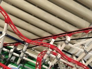

Thats awesome! I thought it was possible with that part v t so glad to see it done! That's huge with 3 sets too! I was going to double up with just 2 sets, 3 looks humongous!
