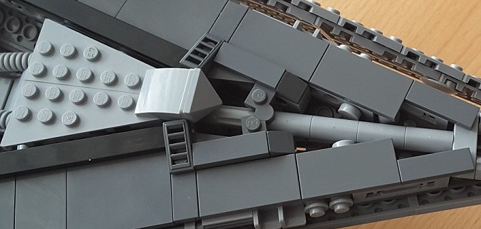

the main problem for me was the connection of the large beams to the centerline with the dbg hinges - page 178
once I connected the beams I noticed that the front section of the model would actually bend down - the technic bricks wouldn`t line up perfectly on my build, so I moved the hinges little up front and shifted the parts around

@Kehtooni I'll check on pages 90 and 97, but it's looking as intended to me. It's normal for there to be a bit of resistance fitting those walls into place---which isn't something you'd run into in an official set, but they should fit with just a smidgen of force. I'll also check on that hinge near the front, although it also looks OK to me. The one you added does seem to fit pretty well, though, so it could be a good idea to strengthen it.
correct, you`ll need a little force to push everything into the right place - especially the outside beams need a little "help"
this is what I ended up with
I first tried to do it as instructed, but as I wrote earlier, the front will bend down
only problem with this solution: there is no solid connection to the center, but its actually sturdy enough and the bottom panels will do the rest ;)
