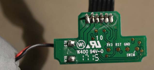

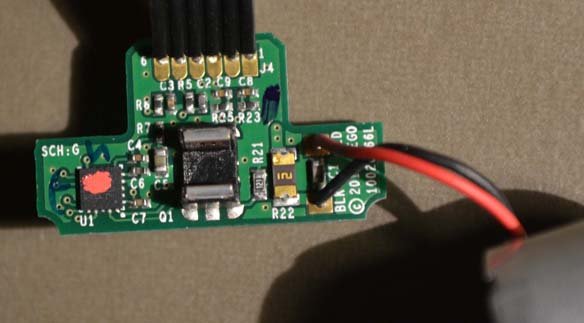

The train motor disassembly got me curious what was different from the inside of a standard BOOST motor.  I couldn't find any pictures of a disassembled unit, so I disassembled my own and took photos.
Board top:
Board bottom:
After I took the pictures, I took some acetone to the red splotch on top of the microcontroller.  It turns out to be an STM8S103F2 (or maybe F3; the only difference is the amount of flash memory).
The pin on the bottom of the board labelled "SWIM" is for the Single Wire Interface Module on the microcontroller.
The rotary encoder sensor is a TCUT1300.
ID1 goes through a resistor, then to port PD6 on the STM8 microcontroller.  According to the datasheet, PD6 is "Analog input 6/UART1 data receive".  ID2 goes through a resistor, then to port PD5 on the STM8 microcontroller, which is "Analog input 5/UART1 data transmit".
My guess is that the ID pins are being used for serial communication between this small microcontroller and the main Hub unit  -- e.g., turn on for X time/rotation/whatever.
