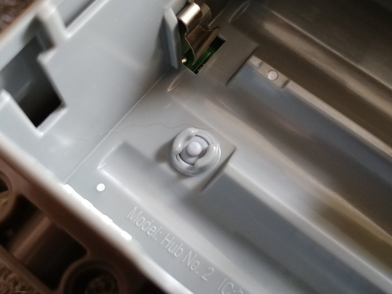

I've just noticed, on the inside of my C+ hub, what appears to be a rubber button. Could this be used to detect a rechargeable battery, just like on the EV3?
