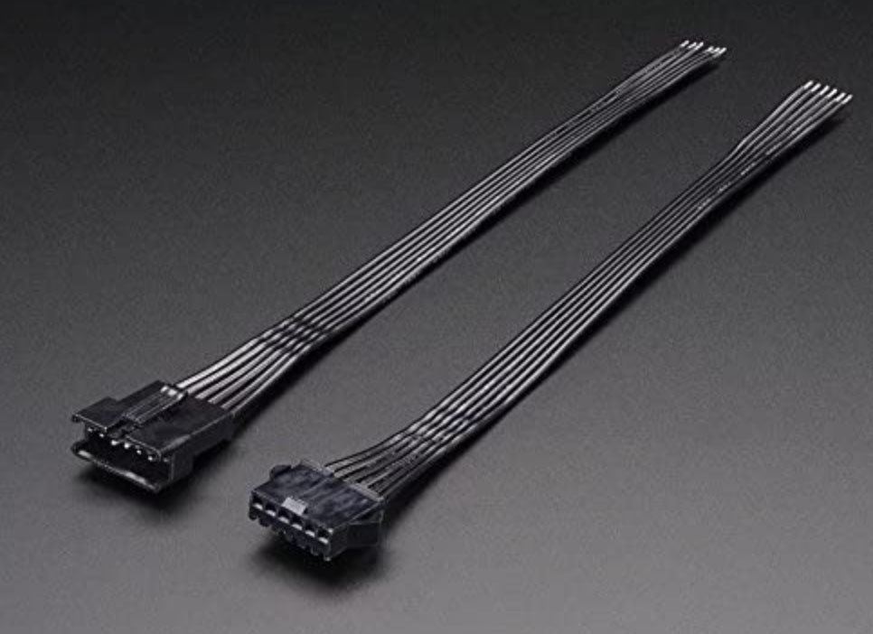

On 9/29/2020 at 12:58 PM, biasedlogic said:
I bet it is protected in some way, but you can't just 'patent a connector'. If we talk patent, we talk some novel property or solution. The plug of LEGO PUP isn't novel in the technical solution - it's just a modular crimped connector in a bit unusual shape, but the shape itself also does not solve any old problem in a novel way. You don't get through the European patent office with something like that easily.
What is easier, is to protect a pattern, like you protect a logo or a trade name. But this has to be recognizable pattern for your company and does not necessarily refer to the technicalities.
Getting around a patent for a crimped connector is not so much of a problem - see my design, it's not crimped and the technical solution to obtain the necessary form is vastly different from LEGO's
Getting around a protected pattern is a bit harder thing, because it depends on what is exactly protected. It may be as easy as making the back of the plug round, leading cable sideways out and making it all lime-green so it looks nothing like LEGO, or something entirely impossible, if the actual shape of the contacts is protected pattern... I don't have time now to poke around and find the relevant IP, but if someone has it on hand I'd love to have a look.
greets!
M.

Another question as some of you posted questions about connectors / extension cables:
As we didn't see extension cables released, even after the new mindstorm set arrived, I don't think Lego will release something like that in the near future.
Another idea I had was to cut the cables of the motors in the middle and attach some small connectors (male + female).
Normally you can just leave these connected to stay with the default length.
But you could use self made extensions using flat ribbon cables and these connectors types instead of the ones Lego uses.
Does anyone know good and small 6 pin connectors?
JST-SM connectors can be crimped for both, male and female and have some protecting plastic around the pins, so they won't break too easy.
And they are cheap and easy to handle.
But not sure how durable they are.
