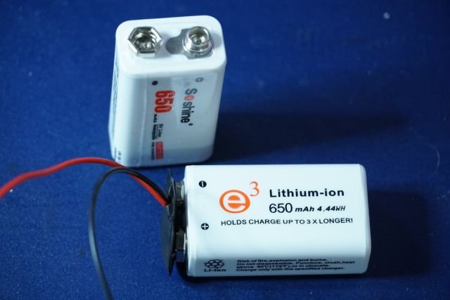

Hi Folks, I promised to report my experiences with the Li-Ion 9V Blocks I've found at ebay.
Not only ebay sells these batteries but there are a lot more online stores, but the battery is allways the same type:
Brandname Soshine, nominal capacity 650 mAh, two cells with 7.4V, no internal step-up converter, made in China

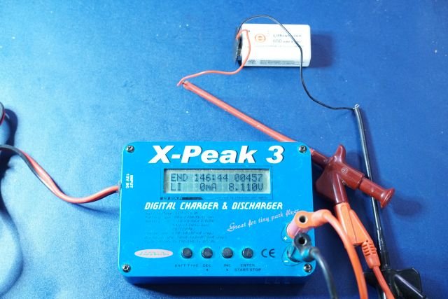

I tested the electrical data with my sophisticated charger, which is also able to test the capacity.
The voltage is ok and like two healthy Li-ion cells 7.4V. I discharged it with 250 mA (typical for pure LEGO train operation) and charged it with 200 mA which is rather quick.
The capacity is about 460 mAh which is quite reasonable and expectable for the battery size, 650 mAh is only a doubtfull ad promise. Perhaps we can charge it slower with 100 mA and the capacity will increase a little bit but 650 mAh printed on the battery is phantasy. But with 70% we are well served. And I've found the internal resistance is very low, common for Li-Ion batteries. This meansour trains will move as fast as with normal AAA non rechargeable batteries. We will notice no or only minor performance drop despite the missing 1.6 V.
The real capacity will operate a LEGO train for 90 min to 2 hours depending on the load. This is satisfying. Please keep in mind the batteries of this type are cheap and are real Li-Ion types rechargeable multiple times.
Conclusion: A recommendable alternative for AAA cells and much more environment friendly :thumbup:
