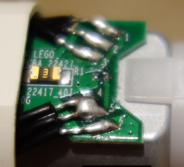

A bit more hacking, this time the new Powered Up M motor (or what it's called). I changed the ID of the motor to the train motor by disconnecting the absolutely tiny 2.2k pulldown resistor in the middle just north of the number 4 (i just turned it out of the way, didn't fully remove it) and bridging pins 4 and 5.
A bit of extra info about the pins first:
-pin 1: motor 1
-pin 2: motor 2
-pin 3: ground
-pin 4: 3.3V logic power
-pin 5: id1
-pin 6: id2
And the ID pin connections for what i gathered from various forums:
-train motor: id1 to 3.3V, id2 to ground
-medium motor: id1 2.2k to ground, id2 to ground
-leds (unchecked): id1 2.2k to ground, id2 unconnected
These hacks are not that nice, but allow modified (useful) operation without hacking the software of the hubs or the remote or using a phone or other computer to control the hubs. Also they are easily doable and look pretty much reversible.

Just a quick remark, it looks like 3x2 pin IDC connectors might fit the PU ribbon cables. These are small 6 pin variants of the old PATA connectors and you can even fit many of them on a single cable. This could allow a rasterboard compatible non lego connector to be added while keeping the PU plug on the end. Then a small circut board could be added as a passive distribution box to connect  for example two train motors and multiple led lights to a single HUB port. As long as only pins 1 and pins 2 are connected on the board and the same type of passive part is connected to it (like train motors * 2 or led lights *2-8) it should work. Intelligent parts, like servos and sensors will not work. The strip could have diodes and other parts to make the added leds intelligent, like lighting up only with one polarity. Plugging in more than one PU plug from this paralleled bunch will probably kill both HUBs or both ports on the same HUB though, so it's not a safe hack, but at least allow the same basic functionality what PF v1 had with the stackable connectors. (including the clever way to fry an IR receiver, a WEDO 1 or the WEDO sensors by using some extension cables wrong)
On the other hand, a PU socket using distribution strip connecting only the first four pins would be neat. (with the 1st socket as full passthrough for the IDs to work)
ps: Took apart a PU HUB without desoldering anything, the circuit just slides out if you push in the battery tabs. The motor driver double H bridge is on the bottom. It's an LB1836, a nice big chip, but really good for only one motor per output. For two train motors, using both outputs or more than one HUB is a good idea.
