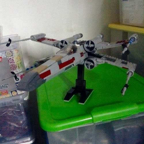

Here.s mine:
I just did some light recolor for my personnal taste and to keep the budget on this as low as possible using parts i had in stock.
Still have to work on the canons as i am not really happy with those long flex tubes and i saw a nice solution on this thread to strenghten the rear i might try ?
47963815703_7bd9517ed9_b.jpg_mg_9994 by m H, sur Flickr
47963842616_545311ab04_b.jpg_mg_9993 by m H, sur Flickr
but now i have that resistance t70 near your xwing moc and it looks so blocky !
