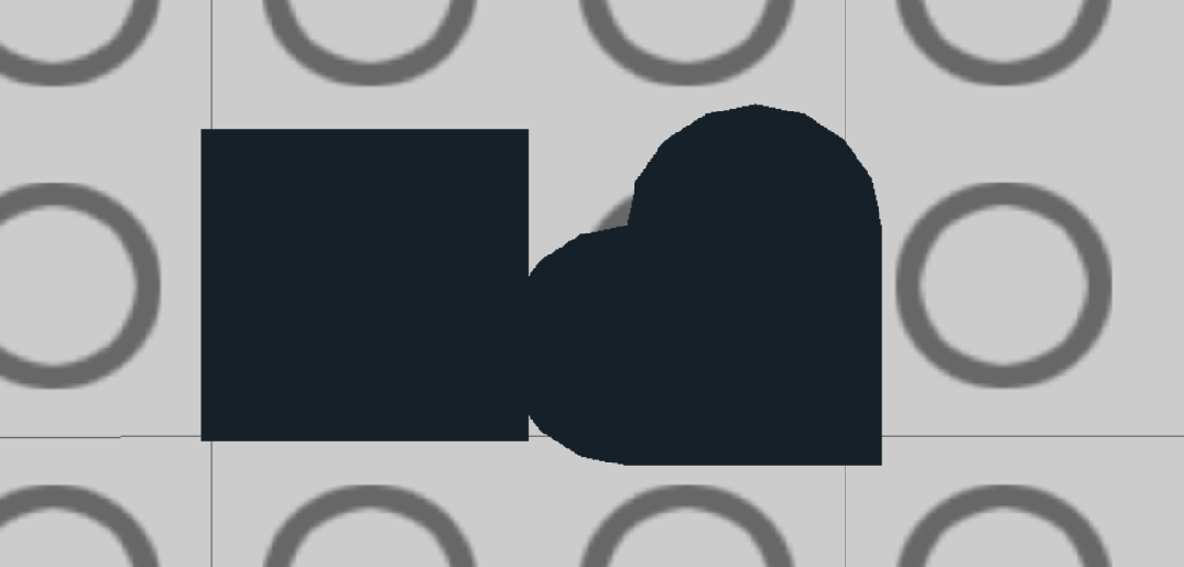

Ok I checked this.
This is the current mod part:
This is the unity part:
As we can see this is basically 45degrees rotated compared to the current mod part. So I assume to use the Unity Version would break quite some builds due to the 45degee rotation.
The current mod part supports also illegal builds as follows:
Also here a comparison of left - current mod, vs right - Unity. The unity has some gap between and the current mod is gapless. I do not know what is the correct way.
The real life way is the left one. I also think that the one from Unity will be harder to use (you have to rotate it 45° every time).
Anyway the unity part seems to be better moulded, it is not possible to modify the unity part rotating it in the same way the present part is?
Yes, that shouldn't be a problem. We can change the 3D mesh and keep the other data (connection, position and collisions). And if necessary re-position the part.

The inner heart is the Unity. The outer (bigger is the current). So one would conclude which size is correct.
Also the unity part does not have a 45degree angle at the front of heart, but lightly more.

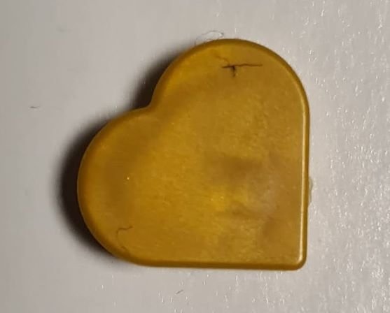

this is the real heart for reference:
looks like the unity is the most accurate one

Ok here are 3 comparisons:
1) Left (red) is current LDD Mod Part
2) Middle (green) is part based on Unity Pack, without any further changes
3) Right (blue) is part based on Unity Pack, but rotated by 45degrees and slightly moved to match position of the current LDD Mod part
Also a comparison of 3) and New Elementary's Review of part. I also added collisions accordingly.
LEGO® MOVIE 2 review: 70830 Sweet Mayhem’s Systar Starship! | New Elementary: LEGO® parts, sets and techniques
I think most likely 3) is the best way to go if we want to replace the current heart. However the addition of collisions (current one doesn't feature any collisions) introduces a risk of 'breaking' some builds. because of collision issues (either the heart piece being removed - or adjacent parts)
Edited by M2m
I agree on 3.
Also, I think that builds that relied on a custom part not having collisions (or having wrong collisions) should not prevent adding or correcting the collisions.  Besides, the risk seems very low with this part.
