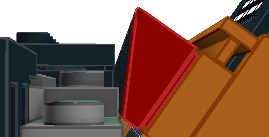

P.S., I did locate two more potential Bricks with a distorted Decoration surface though: Part 15210 and Part 15210 Four-sided Sign With Snap alongside the previously mentioned three Flat Tiles (3068/87079/4150). To confirm this, apply Decoration 93337 onto both Part 15210 and Part 30258. I looked up official images of the two Parts and the actual PNG image of 93337, which confirms that the curved corners do show within the Sign. As Part 30258 fails to show any of the rounded corners while Part 15210 includes the rounded corners but the edges appear to be distorted, it will be best to check both parts together. As mentioned before, this issue does not influence custom decorations or official ones, but do remember these two Parts when the other three Flat Tiles are fixed in the future.
