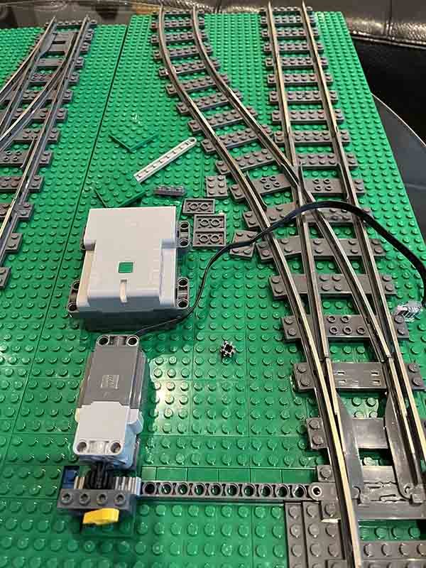

Hi,
I just posted some pictures on my Flickr account of the P40 Left hand switch.
The gap in the module is to place a servo motor in it to command the switch.
The commandbar extention use a Technic Plate 1x6 (4262) and a Technic plate 1x4 (4263) placed on a tile 1x8.
Eventually, this can be replaced with a Technic Rack 1x8 (6630) or a Technic Rack 1x10 (6592) placed upside down.
One end connects to the switch with a Technic Pin 1/2 (4274), on the other side I placed a Technic Gear 12 Tooth Double Bevel (32270) to command the Technic Gear Rack.
I notice some mechanical stress when placing the ballasted switch to the MILS module. :sad:
See here the principle of the command bar extention using the Technic Gear Rack.
Finally I made a single R104 turnout using FX P40left switch and two pieces of FX R104 track. As peviously told, the incorrect alignment for this setup is so small, that the full R104 turnout can work and it is not necessary to use the tight R64P return curves. Of course, the track joints are little stressed, as they are not fully connected, but since tracks built in Holger-curves survived over a decade, I don't think it may damage the joints on long term.
53507888476_337598f324_k.jpg20240204_115858 by Donát Raáb, on Flickr

12 minutes ago, Luxibricks said:
I'm building MILS Modules with automated P 40 switches. Is there a manual for ballasting available for R64 curves?
Hi,
I based my balasting on the one from Dennis Tomsen
Note that this is for MODUVERSE, 1 plate higher than the MILS modules from L_Gauge.org
Top side
and
Bottom Side
for the L-Gauge 'system' see my backside here:
I recomment the use of the 'plate 1x2 with door rail' as you can see in my picture to prevent the 'Plate 1x8 with door rail' to pop off.
Some of my R64P curves got the problem that certain  'Plate 1x8 with door rail' where popping up , others not.
By replacing them by 'Plate 1x2 with door rail' could I prevent this 'problem'.
  • 4 weeks later...
Thanks @Ludo for the instructions.
Here is the final result, 2 72 studs long MILS modules, each with a PU Hub, a L motor and a color/distance sensor. Everything will be controlled with BAP.
