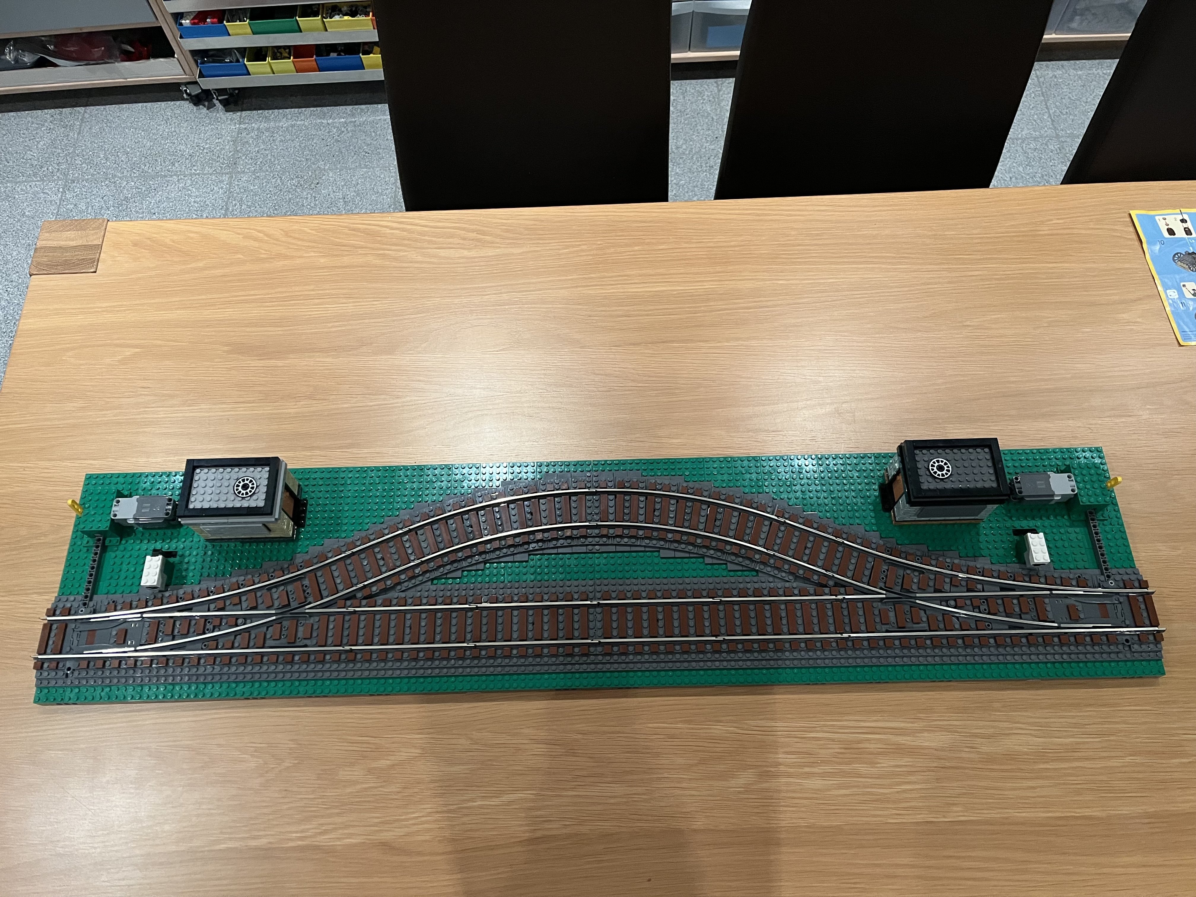

Here is the final result, 2 72 studs long MILS modules, each with a PU Hub, a L motor and a color/distance sensor. Everything will be controlled with BAP.
@michaelgale Are there any news concerning the release of R120 / R136 / R152 ?
I love this! Maybe a n00b question but is P40 the standard Lego switch or a custom size?
They are 40 studs long and use a similar geometry to the trixbrix and bricktracks r104 switches, but they can not be sloted in to the same space as a lego switch
