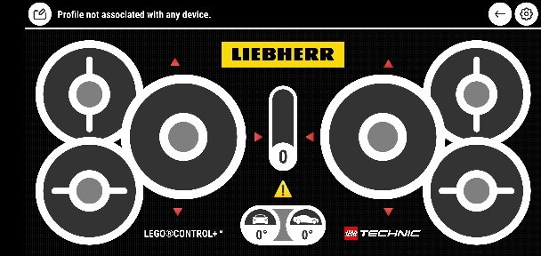

I wanted to try the app for a long time now and finally had a few spare minutes :) I really like the customization options, it's great to have an alternative to BrickController 2 for the ones who prefer the on screen controls! I tested it with 42109 quickly, I share my findings if you don't mind:
  • Controls elements default to the 10% speed when created, is it on purpose?
  • Calibration works great, but the Servo function is often laggy and does not respond every time to quick changes.
  • For the buttons it is confusing to have the ability to rotate them on screen but I also need to choose servo/run in the settings, you don't have the same for the single-axis joystick. First I simply turned it to vertical and did not understand why it does not move the XL motor. So the acceleration works properly, but I could not make it work for steering. The calibration runs fine but then it only turns the wheels a few degrees.
  • If I start a motor with the slider then it holds the speed even if the app is minimized and holds it until the app is killed. It's great for train models but not sure if it is a bug or a feature :laugh:
You've made a great progress so far, hope to see new updates coming!

Thank you very much for taking the time to test the application and sharing your opinion.
Checked, when creating a component in run mode, I have a speed limit of 100%. 10% is a behavior incomprehensible to me, I’ll check the code.
According to the servo drive, my implementation is not the best, I will never stop improving this part) thanks, I will conduct tests, try to figure out the reason.
Orientation change and selection of element modes is in the intermediate stage. Everything was more limited before. Now I am going to give the user complete freedom of choice and customization.
At the moment, the program’s operation policy is as follows, connections are not broken, cancel commands for motors are not sent. it may be worth revisiting this point in terms of stopping the motors when driving.
I will continue to work on improving the program)

I'm trying the new features, adding image and text will make closing & opening profile is taking some time @ lag. Is there any memory issue? There is some layering issue, the image sometimes not stay at it place, going back or front on other image/control button
I would like to suggest additional double axis joystick function that can be used to drive 2 motor in a tracker. Currently it only suppot drive & steering cars
Hope it helps
