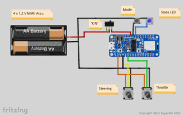

I have just started a number of small projects:
a) I will strip a given RC Controller , former used by an RC car, i will keep Buttons and handles but replace the electronics.
    I will use LED Buttons, potentiometer for steering and throttle and connect all an Microcontrollerboard that supports BLE.
   I wil start with nrf52840 feather express Board from Adafruit, others are, ESP32, Ardoino nano 33 BLE, RASberry PI and many more
 b) Other Idea: The Brickcontroller app akts as a Sofwarebridge between an GameController and the LEGO Hub.
      In my case i will use my Board acting as a hardware bridge between an Ordinary RC controller and the LEGO HUB.
     The reveiver of the RC System is connected to my Board. My Board reveives and computes Control information from the Reveiver                   channels and translates them by using the commands taken from the LEGO BLE spec.
  Advantage is, that it woks without any changes on the hardware of RX system or LEGO hub.
Simplest forrm of an BLE  Handheld Controller for the LEGO HUB, based on:  https://github.com/corneliusmunz/legoino
  • Take a ESP32 based affordable development board of our choice
  • Setup your Ardoino or Plattform.io environment
  • Add  a pair of simple jostick gibles, Buttons, LED, what you like
  • Have fun
Happy new year, Marc

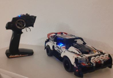

Hello all,
to make a long story short: I have just created my first "Worbase" about Bluetooth Low Energy Handheld Control sets
To do so i have replaced the build in Controller with Adafruit nrf520840 feather express, it fits nicely in the casing, during development and test it is more convinient, place it outside on top.
Pros:
 --> Car works as expected with respect to limitations according to electrical power (current rating) and mechanical tolerances.
If i have time, and documentation article was published, i will explain in more detail "somewhere else", ask if interested , about what you want to know.
Greatings
 Marc
