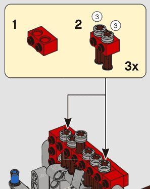

amorti Posted January 3, 2022 Posted January 3, 2022 I did some minor mods, no parts required. Nothing to aesthetics, because to me this already looks plenty good enough for a technic set. It's all about the functions! The 5.5L axles on the 2nd axle stick out too far compared to those on axles 3&4. So at step 8 swap them for 4L axles with stop from bag 4, which are for the winch ratchet levers. You can then use the 5.5L axles on the ratchet handles in steps 623 and 630. There are two red 1L axle bushes in the spare parts to put on those so they look more like function parts. Swap the 16:20 gear pair on the crane rotation input so you can actually use that function without getting out of breath. They go on at steps 60 and 74. The 20t gear is close to hitting the 2*4 liftarm that raises the 2nd axle, but there's no actual collision. Same goes for the rear lifter input. At step 100 put the 20t not the 16t, then at step 104 put that 20t in, instead of the 16t. Again, it'll make the function actually usable. 27 minutes ago, anyUser said:  Raising the brown axles by (almost) 1/2 L will remove the issue. Yep, I found the same. Quote
