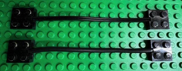

These videos are well over 10 years in the making.  The main thing holding me back from making a guide to repairing and testing Lego 9v / Mindstorms connectors and sensors was finding the absolute perfect wire to use.  That day has finally come.  I'm using a 6 conductor, 24 gauge wire with a thin and very flexible silicone insulation.  The problem I've always had with replacement wire was the oversized insulation thickness and inflexibility (not to mention that hideous white line down one side.  Once split into 3 pairs it works out to about 44 cents per foot if you get the 25 foot roll.
https://www.amazon.com/gp/product/B07PPT11QN/ref=ppx_yo_dt_b_asin_title_o01_s00?ie=UTF8&th=1
I know there are plenty of guides out there but I've always been frustrated by them.  I've been making my own Lego 9v wires for over a decade and soldering for over two decades.  I wanted to pass on all I have learned in a somewhat rambling video  :pir_laugh2:.  I only solder the connections to the back of the sensors, everything else uses the same system Lego used.  I hope the Lego community will find these videos useful.  Any constructive feedback is welcome.
Edited by BatteryPoweredBricks

These are excellent guide videos, and I really like the wire you found, looks better than the stuff I've been using. The issue of old wires deteriorating comes up from time to time, will definitely be sending people to your videos.
Only thing I would add (actually no, would be better as a separate video) is that the second biggest problem I have found with these cables is corrosion of the electrical contacts. Only takes a small barely noticeable amount to stop the electrical pixies flowing! Can be cleaned easy enough with contact cleaner but I'm still trying to find a way to get a nice, shiny, like new condition.

Thanks for the kind words, I was floored when I found this wire and had to share the news far and wide :laugh:.
That's true, I had some connectors I threw out because they were so bad off.  Most of my connectors came from large eBay lots, some from goodwill sellers.  I wasn't sure how widespread the issue of corrosion on the actual contacts were for others.  Always on the lookout for guides to post to help out the Lego community.  I'll always have a soft spot for the 9v / RCX era of Lego electronics and it's cool to see I'm not the only one after all these years (there are dozens of us!)

Great video, I'll have to try this on many broken 9V wires I have. The wires with the rubbery insulation are very prone to breaking over time, while the ones with the glossy insulation hold together better. The metal contacts and conductive plates have held up better for me, but they are mostly from sets I opened myself back in the day.

Great Video and great find on the wire.  I tried repairing a cable last night and had no luck.  Watched the video again.  I think my issue is I wasn't tucking the wire with my driver into the pocket. It is probably allowing the wire to slip out of the prongs while pressing the connector pieces together.  I'll give it another go tonight.
Yeah skipping that step could cause the wire to pull back and not meet up with the blade contacts.  Also make sure the blades are straight up and down, they tend to get bent when pulling the connector apart.  The more you do the easier it gets.  I've put on a movie and made a couple dozen at a time and only had one or two errors.  Good luck!
So Tucking the wire did the trick,  and after a few it gets easier.  The wire I found was in a single strand but a 2 pair and I basically stripped the ends and folded the wire over itself a couple times and used the pressure of the plastic to make the contact.  Have had no issues, but was not nearly as easy as this wire is.  It is somewhat flexible but not like the silicone wire.  Now I just need to find more wire - you wouldn't want to sell some of yours would you?
