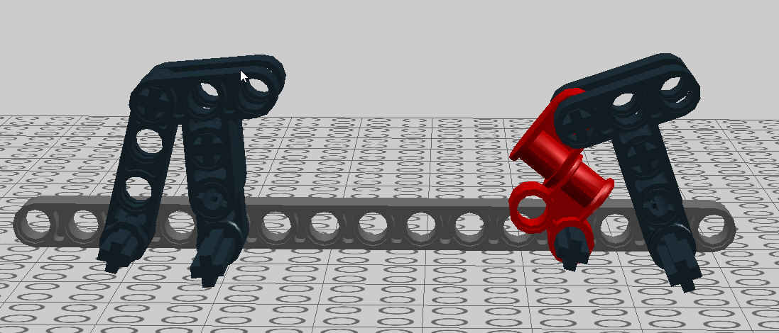

I've also updated the side mirrors, saw this on some Cada car I think. Don't have a #3 connector in black yet, but I'd also like to try with a #4, which I also don't have, to see how it looks.
I'd build my side mirrors like this:
By using a click hinge 85x85p.jpg?1658326063.039821 we can transition to a plate 85x85p.jpg?1658326031.367818, from where we arrive in System-land, such we can build the mirror thin and elegantly (IMO)...
