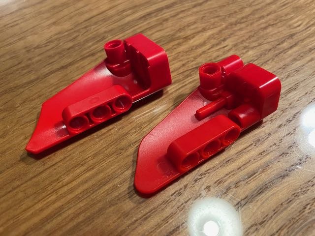

Am I the only one getting my butt kicked by this step?
Even with the original designers input (above) my rear spoiler is bound up.  Especially when I add the "side modules" to the rear bumper.  I also can't get the spoiler to sit low enough when I add these parts.
I've rebuilt this about 3 times thinking it was an issue on my end.  I've scoured the internet for all the videos and pictures and can't find anything wrong with how I've built things...
Any help would be greatly appreciated!
@blbills Sorry to hear about your struggles, however I have insufficient information to draw any conclusions. Most likely you have made a mistake anyway:shrug_confused:. For clarity, picture you quoted was not to fix anything related to the spoiler itself, but it was to simply show how it was built in my original design. With the subassembly in the CaDa set the engine cover is pushed up by one stud meaning it can't close nicely.
Edited by T Lego
The problem is probably because of the differences between Cada (right) and Lego (left) Parts. The Cada part has an additional pinhole which takes to much space for T Lego's fix.
Bingo!!!
The second I removed these parts (labeled R5 and L6) @T Lego's fix worked like a charm.
I guess now the question is to either replace these with TLG parts or try to come up with a separate fix using the CADA parts that addresses the original need of the rear hatch not closing fully...
It seem like either way this is something I can address after the build is complete.  I'm tempted to move on for now.
Let me know if anyone else solves this in a creative way.
Thanks!
5 minutes ago, blbills said:
Bingo!!!
Nice, good to know! That perfectly explains why the R&D team changed that part of the build in the first place, too bad it created a new problem with the engine cover.... Back to the drawingboard to find new assembly fixing both issues. Any help is appreciated because, again, I don't have the cada model. Apologies for the inconvenience..
