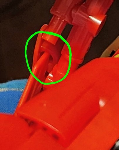

I do want to elaborate on the sagging engine cover: In many cases, this occurs because of incorrect orientation of the tri-connector as illustrated here:
I do recommend trying to re-establish the encircled connection below, which the R&D department removed.  The red pin connector would clash with their new panels, which don't have the half-stud gap below the #13/14 panel. This will add some needed rigidity in the engine cover. A fix for this is included in my V3 as well, but I currently cannot provide a better illustration unfortunately.
Yes, you are right! I had that part built incorrectly. Unfortunately, fixing this still didn't really help with the sagging of the engine cover, so I've reinstalled the 3mm rigid hose connection. This continues to add a lot of rigidity to the engine cover, however it then started coming apart at the axle connections underneath the black liftarms framing the engine window. What is needed to prevent this is a connection from these liftarms to the connection points below (towards the flag-end of the window). See below:
I've found two possible solutions to this, one purist and one not. The purist solution uses 15100.jpgplus 3L pins (in place of the 3/4 pins). This works, but pushes the tip of each red panel above slightly upwards so it doesn't sit flush with the black liftarm framing the window.
The non-purist solution fixes this, using 87618.jpg instead, with the long end pushing through the center of each 3/4 pin below. The non-purist part is that the extending long ends need to be cut short to avoid hitting the engine below. Here's a picture of this solution implemented along with the 3mm rigid hose reconnected at the top of the engine window (I'll be swapping the cut grey bars to black as soon as I can get some):

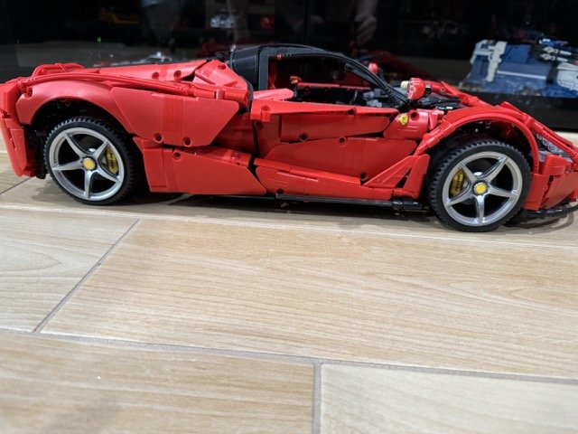

The LaFerrari is finally 99% there, constructed from genuine LEGO parts - apart from third party rims. I went with the modification @astyanax had produced on his example eliminating the flex axles around the front tyre and replacing with 488 GTE guard. Also replaced the Systems parts above the front tyres for a more robust Technic parts.
Hi LegoHoops,
is it possible to share your modifications to the LaFerrari? I am quite struggling especially in the integration of the 488 mudguards and would appreciate some help and as I learned from browsing through the forum astayanax more or less can't remember the mod details anymore. But I can also understand if you can't/won't share your solution, totally fine.
Thanks in advance and best regards

@Scapuc
The LaFerrari went through a couple of changes since that photograph, I don’t have the LaFerrari here anymore - it’s 500kms away at my parent’s place. I’ll need to have a look at some older working photographs from 12 months ago over the weekend and refresh my memory.
Mostly Angled Connectors, Short Pins, 1/2 Pins and 3L Bars……
