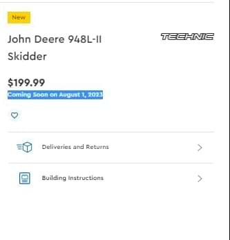

The Lego site has different release dates for different countries.  The UK is the first of June and the US is the first of August, I haven't seen Lego do that before.

7 hours ago, Maaboo35 said:
This set is releasing in June, so we should be seeing reviews later this month.
Maybe it will be releasing June in other countries, but according to the United States version of the LEGO website, its quite clearly not releasing until August 1, so most of us west of the Prime Meridian still have a few months to go before the set launches. See below attached image.
