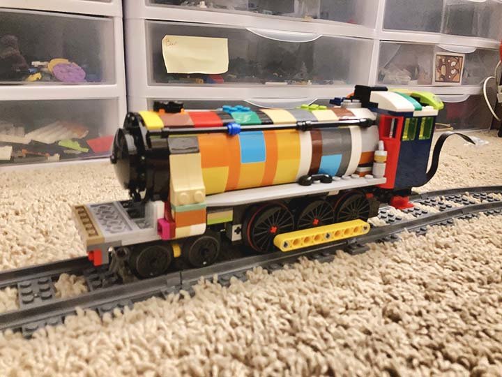

Just made an OE locomotive largely unchanged but with BBB XL drivers:
Thank you for testing this out. This tweaks helps balance things out even further - I'm a fan!
Now I would add some studs to the boiler, to make it more scale like, and a medium BBB wheel at the back. Otherwise, I prefer the normal wheels.

And speaking of posting to keep everyone in the loop, the test worked! - and worked well!
I'll update the studio model accordingly, and share both that and the footage sometime soon.

Here is the test video, and a photo of the prototype used for the test.
@ToledoRails, here you can get a good idea of the cable length if you were still concerned about that.
Anyhoo, I want to spend a bit more time refining the studio model (dividing it into groups for parts that need to be added vs reused, nice colors, etc...), so that'll arrive whenever I am satisfied with it. It may well be tonight :laugh:
