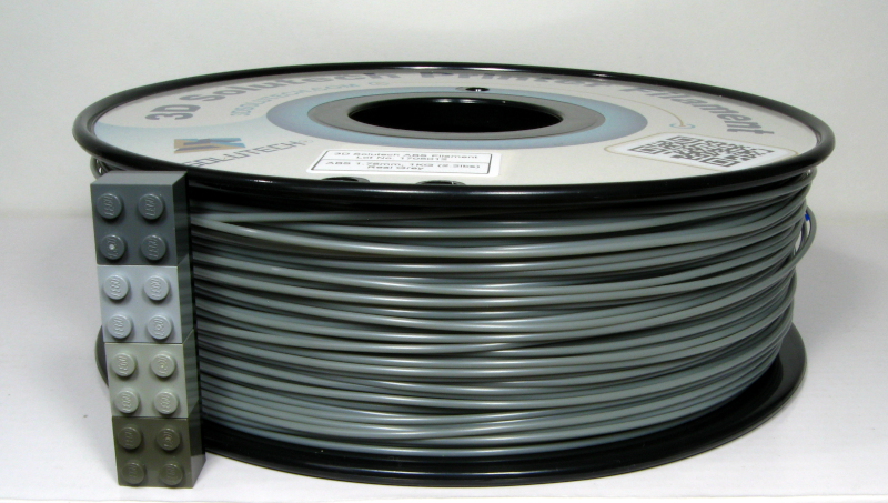

dr_spock Posted October 31, 2024 Posted October 31, 2024 I tried Solutec grey ABS for connecting rods on my Bley Night version of LEGO's Emerald Night. Quote
