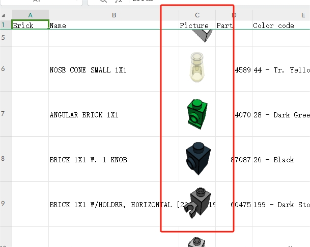

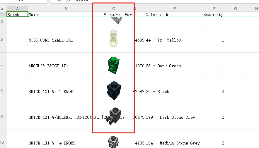

I'd like to know if I can export partlist with pictures  to excel?
I know there is possible to export xml、csv file, but without the pictures.
Thanks in advance
BigHank
