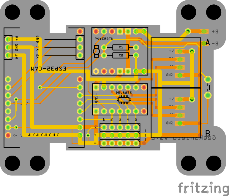

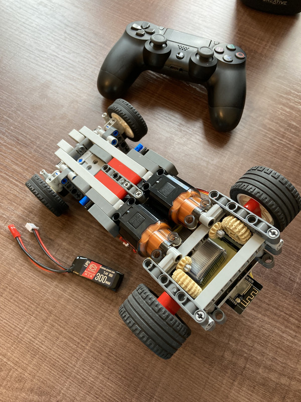

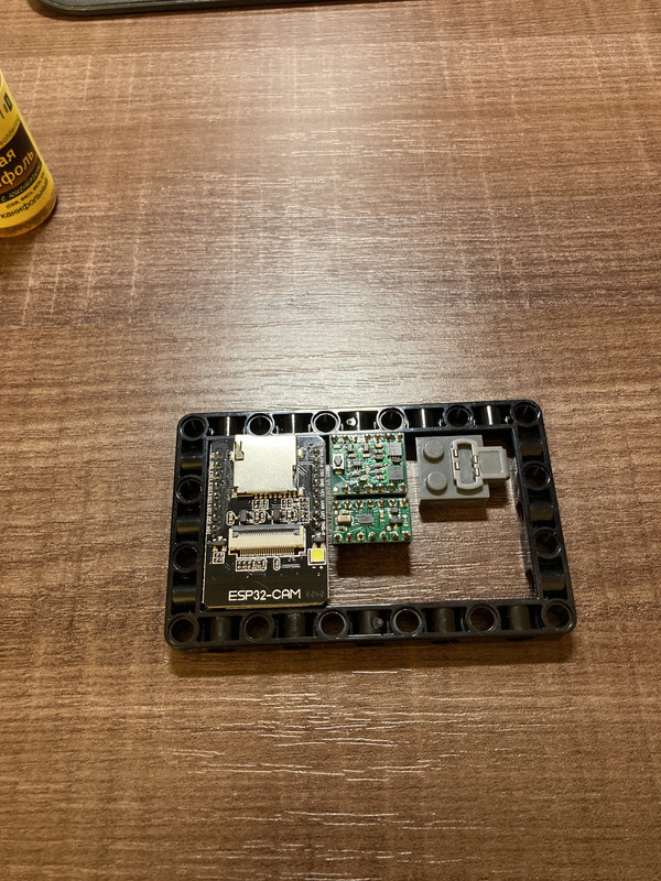

LabManager Posted January 20 Author Posted January 20 (edited) Finally, finished the PCB design for my all-in-one controller. Hope to get the order soon and share some videos of how it works. For now, just a few words of what it is going to feature: 1) ESP32-CAM as the core. That'a a pretty old ESP32 board, but there are many reasons to use it: - it has BT-Classic support (it's still used by most gamepads, not the BLE) - it has relatively small size (newer ESP32 are even smaller, but they have only BLE) - it's cheap and widely available 2) Power control (Pololu Mini Pushbutton Power Switch) - power on/off with a clickable button, that's definitely more handy that connecting/disconnecting the battery every time - more important, it also allows to shutdown the power supply automatically when the battery voltage becomes too low to run the controller & motors 3) Dual motor driver (Pololu DRV8835 Dual Motor Driver Carrier) - tiny size - lots of builtin protections (reverse-voltage, under-voltage, over-current, and over-temperature) - good operational ranges (11V & 1.2A by specification, but the datasheet tells that up to 12V and 2.0A per channel at peak are OK). That should be enough to power PF motors 4) 2x PF sockets glued directly onto the PCB. I didn't find any better way to connect the motors 5) GeekServo 3-wire pins - as the ESP32-CAM board has limited amount of outputs, there are two possible scenarios: - option A) 2x PF motors + 1x GeekServo - option B) 5x GeekServos simultaneously (in this case, the motor driver is not required to be installed) - the GeekServos are powered directly by a 2S battery, which seems to be OK, (as @oracid suggested). But, the PCB will also have the connections to add a regulator to reduce the voltage for servos down to 5V Of coarse, it's still a DIY-controller and even a beta-version of it. I didn't make any endurance or safety tests of this, however the breadboard prototype has successfully worked for some hours some weekends when I worked on it. It's really hard to make a DIY board small enough , so its size and number of ports ratio is not comparable with common products. But: - it's really cheap ($30 for all components). Almost the half of its cost comes from the 2S LiPo battery. - you need just basic soldering skills to make it (as for me, I'm not ready to get the reflow oven and setup the SMT process at home) - it can be directly controlled by Bluetooth gamepad without using the smartphone as a proxy - it can control the GeekServos - not sure that this is an advantage, but it allows to be configured by writing real code in Arduino IDE Anyway, this mess of wires is going to become a PCB with size of a 9x5 frame + some extra pin holes for mounting + space needed for the battery (greatly depends on its capacity) While waiting the PCB production, also made some tests trying to make a drift car. This car has independent motors for left and right wheels which can be controlled by ESP32 in some way to make the car oversteer/understeer (something like torque steering). However this has no effect... So if anyone has suggestions how to make the car drift properly, that would be very appreciated :) I'm also exploring the option to upgrade 2S to 3S power supply so there will be more torque from the motors. However, 3S battery will supply up to 12.6V when fully charged, which is more than DRV8835 can handle by specification. But since I have some spare DRV8835's I'm going to try that soon :) BTW since this topic is now much more about Arduino and the DIY-controller, I'm planning to create a new topic when the final PCB is ready so the topic name will not be confusing (there is no more Mould King servos-related information here) Edited January 20 by LabManager Quote
