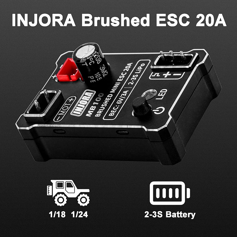

Control Electronics
For control, I am using this Injora ESC. It's quite small, about 5x3x1 studs in a nice housing that can be easily attached to Lego parts with sticky tacks and has a turn-on button and status LED. It is designed for smaller scale RC crawlers, but for lego motors it is more than enough, and allows for quite precise speed control. In fact, in the video the model often moves slowly not because that is its max speed, but because I wanted to move with precision; its top speed is much faster than that. Apart from that I use a FlySky transmitter and receiver, and a 3s LiPo.
6_ac8aad33-d0da-4ff1-b345-d229011c4c95_1
I also had to make some custom cables for connecting the motors to the ESC and splitting the output of the ESC for the two motors to avoid stacking them on the same PF port (I made several versions).
Unfortunately, currently the cables result in a bit of a mess.. It would be nice to house these electronics in a 3d printed box or something..
