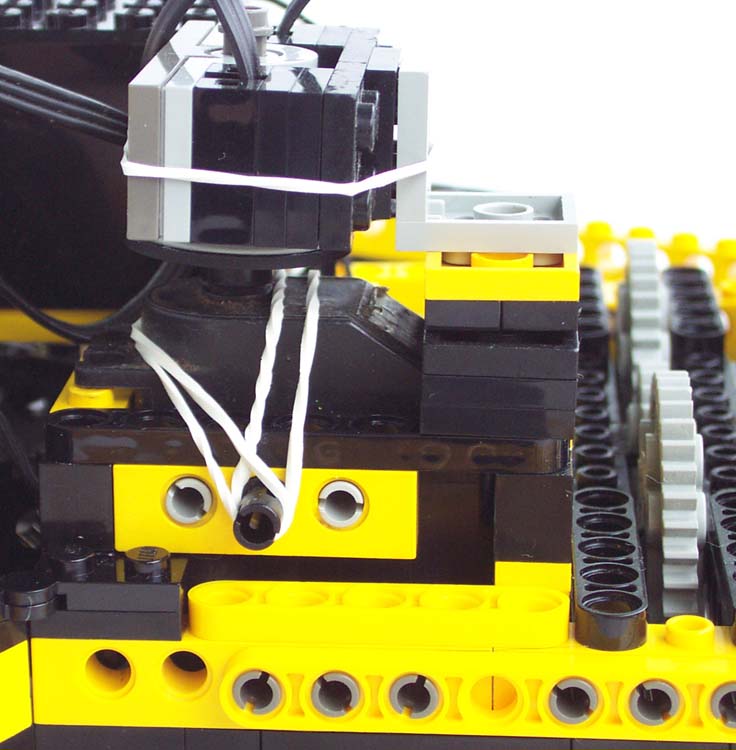

Tobbe Arnesson Posted February 19, 2010 Posted February 19, 2010 You don't need special hardware to fit non-LEGO servos into a LEGO MOC: Se more photos of this MOC here: http://lotekbricks.blogspot.com/2001/04/rckillough.html But you can't get proportional steering/power this way, the polarity switches are either on or off. Adding more non-LEGO hardware can solve this. When I used this system back in 2001 I was trying to find someone who could build a custom "servo" that took the signal from the receiver and controlled a 9V output instead, that way it could have been proportional. But I could not find anyone, not that I put that much energy into it... Quote
