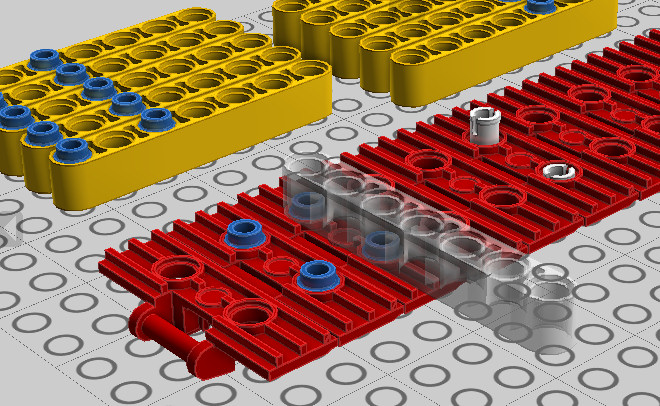

As seen in the SS, when I move over the treadmill, it does "align" to the holes but won't go in it at all.
If you use the 1 1/12 pin (part #32002) rather than the pin with stud you're using it does work. I'm not sure if the original is a legal connection or not, but using part 32002 probably gives a better connection anyway.
It does seem like the studed pin will not connect "stud down", so that is a "bug" in LDD (but trying that connection with physcial bricks I notice the fit is extremely tight - more so then with ordinary technic holes).
However, it connects fine in LDD with "stud up" and then you can connect the Technics beam that way (would that solve your problem?)
Strangely though, the pins can be placed illegally in LDD as shown by the white pins.
That works. I thought it was odd that what worked with real thing wouldn't work in LDD
That one should be reported to LEGO.
