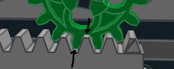

A small 'borderline' problem. I encountered this one while building an alternate version of Creator Set 6753 Highway Transport in LDD 4.1.8 Extended.
The model features a crane with Gear Wheel 4019 and Toothed Bar 3743. Initially LDD wouldn't allow the gear wheel to fit.
Only after making the snapshot I realised why: because the tooth of the gear wheel is directly above the cavity that is created by the ends of two adjacent toothed bars. Apparently, the depression at the brick ends is less deep, because LDD does allow fitting the gear wheel above the other spaces between the tooths of the toothed bar (are you still with me? :wacko: ).
So it is actually a minor problem, more of a nuisance - just make sure you do not have to fit the wheel straight above the end of a toothed bar. :look:

Here's a mock-up of the problem: LXF
The red gear wheel will not fit onto the toothed bar, no matter how many degrees you turn it. The green wheel fits perfectly.
The difference between the two geared wheels is their position above the toothed bar: the red wheel is sitting right above the outer end of a toothed bar, while the green gear wheel just sits over the toothed bar. Even if you take away either of the two toothed bars, the red wheel does not want to fit. I therefore assume there is a boundary problem with the ends of Toothed Bar 3743.

Maybe this picture helps explaining:

@Calabar, there's nothing wrong with the dummy. But if you open the LXF and zoom in you see the following.
Since the teeth are quite clearly going into each other that was why I was wondering if the build was legal or if it was a modelling error of the elements in LDD.
@Sjiup - When the cogwheel is placed at a slight angle (like the green one), the colission boxes (cogs) don't touch the base of the teethed bar. However, when the wheel is placed 100% perpendicular (in the red case), the boxes (cogs) touch the teethed bar and won't fit. So my conclusion is instead that it is the cogs of the cogwheel that are too long, and not the teeth of the bar.
Anyway, I'm reporting this littel sucker to TLG, and we'll see what they say. :classic:
@Sjiup - Now, about the error; In each cog there is a rectangular colission box. When the cogwheel is placed at a slight angle (like the green one), the boxes (cogs) don't touch the base of the teethed bar. However, when the wheel is placed 100% perpendicular (in the red case), the boxes (cogs) touch the teethed bar and won't fit.
