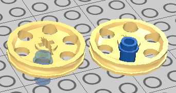

Can someone confirm that the 6942 Lamp Shade has a hole also in the old SCALA sets from the late 90's. Otherwise we might be looking at two DesignID's - one with, and one without the hole.
The part is used in many SCALA sets, as well as the Battle Of Endor. In BoE, it is a trans-clear stand with a trans-clear bar attached to the top.
With the wide, open side of the dish on the floor, the bar cannot be attached.
Yes, I know the dish that is in the BoE has a hole, but does the 6942 that was in the old SCALA sets also have a hole?
I've no idea. They're listed as the same part on Bricklink, so I guess it does also have a hole.

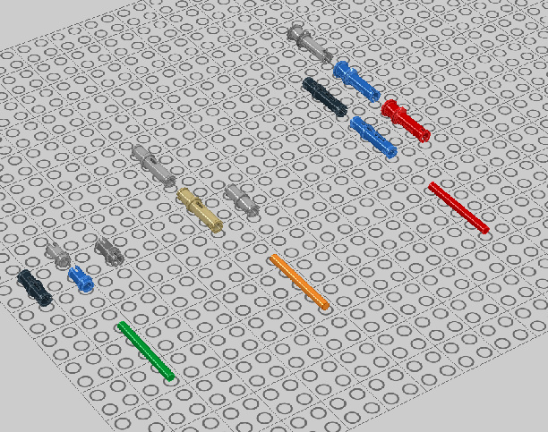

Also, some technic pin parts do not allow bars to be pushed in such as 'Module bush' and 'Stub w friction bush 3 m'
32138 and 41532 should most likely allow 3.2 bar in one module, but as you've pointed out this is not supported in LDD4. Does anyone know if this a technique that has been used in any official set for these two parts?
Regarding bushes and 3.2 mm bar in general, here's what's LEGO legal (and it now also work like this in LDD):
Allows the bar completely through
2780, 4274, 32002
Allow bar one module in
32556, 3673
Does not allow bar in at all (physcial stop at end)
6558, 32054
See attached LXF. I've used a red bar to signal that it can't go through, orange for one module, and green for all the way through. Neat, huh :laugh:

32138 and 41532 should most likelky allow 3.2 bar in one module, but as you've pointed out this is not supported in LDD4. Does anyone know if this a technique that has been used in any official set for these two parts?
2780, 4274, 32002
32556, 3673
6558, 32054
Cool the bar can now go through friction pin like it should!

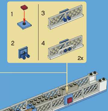

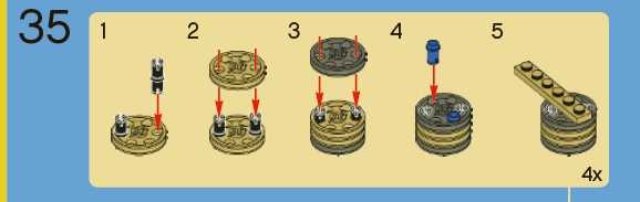

I started doing the new Tower Bridge 10214 and so far find 2 problems.
Things that is not possible to do using the LDD 4.0 but described in official
building guide.
1. This is not doable the four wheels cant fit in that space because the
blue pins cant go in as deep as needed 4185 wheel 4274 pin (the same is the black pins)

2. I can't find the the way to do this in LDD also. Is it legal building or not. I assume if it
not legal then it not printed in official building instruction.
