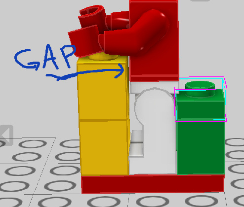

I am building a Scrambler amusement ride and in the red surround, the technic half-beam, although it's sitting on the studs should stay attached. On the other hand, the technic beams, half beams, lift arms, etc. don't connect to studs.
